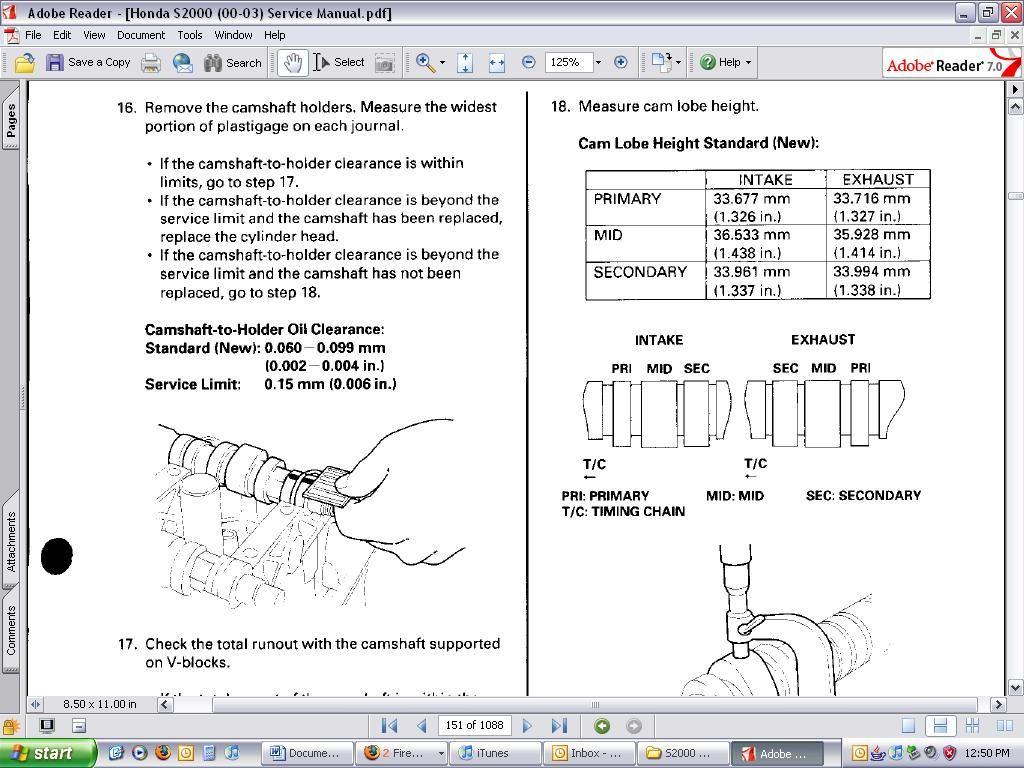

just wondering what the lift and duration was on the stock ap1 cams

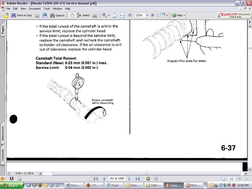

EDIT: The pic is too small for you to see it. I'll have to make two smaller ones. Patience
... Fixed
I hope this is what you're looking for.
It is for the AP1 car.
I am not responsible for the source of this image.
