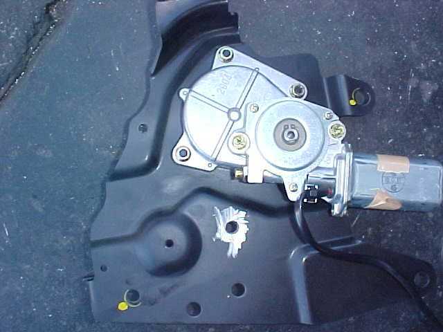

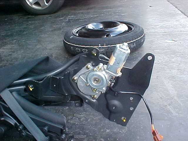

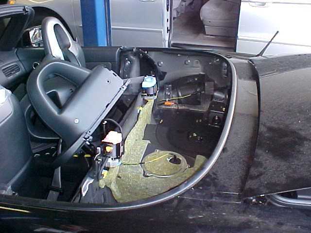

I have recieved a few PM's asking about taking the soft top out so I thought I would show these pics. I did it about a year ago when I put on the hard top. If I want to go topless, I just leave it at home, it is not a big deal (rain pending).
I have not weighed the top, but my guess is 30-40 lbs, which I more than put back in when I put a 10" sub back there.
MAtt
The finished pic before the stereo
everything out
Area where the welds must be cut they are just spot welds to make sure the bolts do not back out. very easy to cut!

It took my guy about 4 hrs to do the whole thing.
