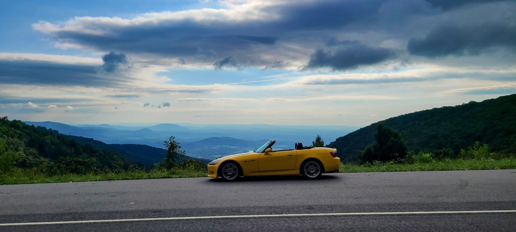

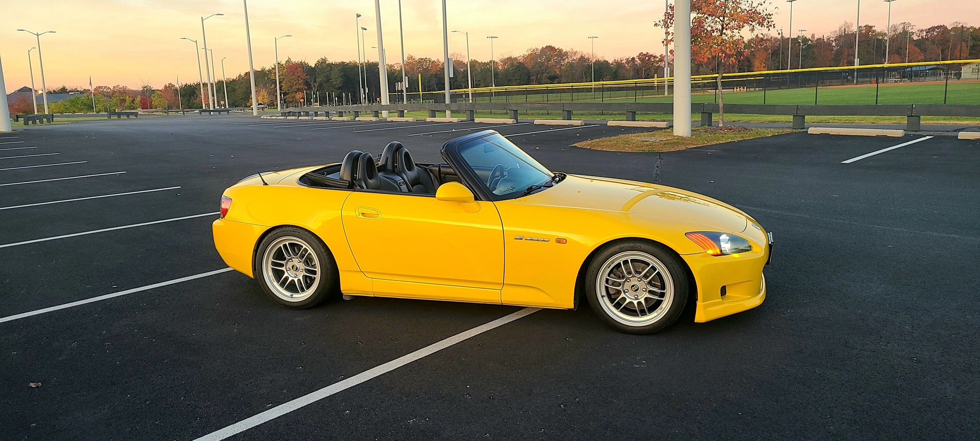

I've been reading this amazing forum for over a decade now (should be commenting more, but I learn so much) and I picked up a 2002 AP1 4 years ago. A few months ago I got a SOS Stage 1 Supercharger kit for it - already addressed handling with bigger wheels and tires (255 rears) and Ohlins R&T lowered 1 inch and some underbody bracing.
I read a lot of the very informative threads here and on Reddit about supercharging a S2k. But I didn't get a change to drive one so I was hesitant. I was also considering swapping the S2k for a 2016 GT4 or Boxster Spyder, as given the cost of supercharging (~$10k), I could put that amount and what I'd get for selling the S2k realistically toward one of the Porsches. Then I drove a GT4, and while I loved it (everything is just about perfect like most Porsche sports cars) it wasn't as raw, nimble and exciting as an S2k. So I decided to supercharge vs trading up, and keep my S2k.
Was it worth it? In one word: YES!! In more words, it solves the one shortcoming of the S2k vs higher end (or more modern) sports cars, the fact that many modern daily drivers are faster than a 20+ year old roadster. The other day I felt even better about my decision when I did a few 20mph to relatively high mph runs against a 718 Boxster Spyder. The stage 1 supercharged S2k ran pretty much even consistently, maybe half a car length down, on the Boxster Spyder which was PDK btw.
I'm coming from a tuned 2016 C63s AMG so have done the torque thing. That's not the S2K - even with probably a stage 2 supercharger it won't push you back in your seats with gobs of torque. But, if you want a fast, for the street at least, very balanced and engaging car, that I personally chose over a GT4, I would recommend supercharging. Also, for me, for mostly street driving the Stage 1 is more than enough, for an engaging, balanced and most importantly reliable car. Just wanted to share these thoughts with you all. Attaching a couple of photos of the engine bay and my car here to make this post a bit more visually interesting.
