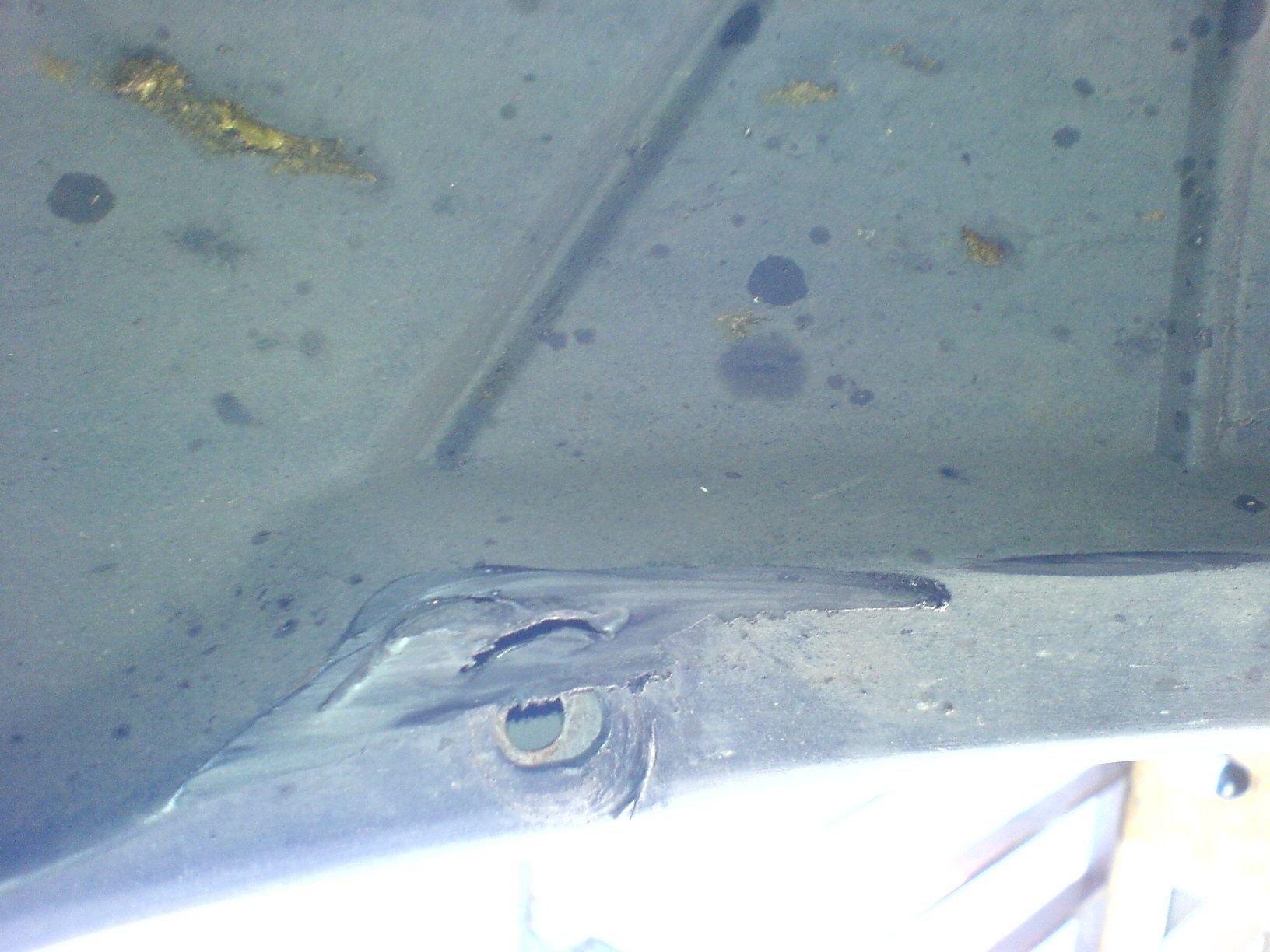

That's the extent of the rubbing from a serious Jock hoon.
