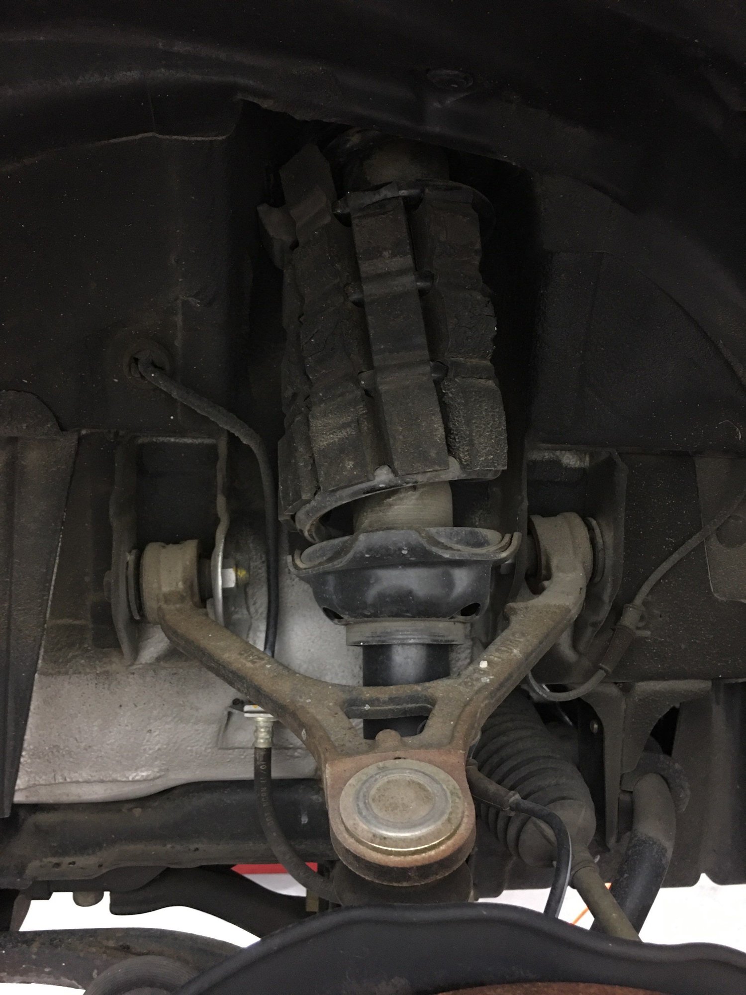

Hi!
I just bought an '02 (29k miles) and had it serviced (fluid flush, valve adjustment). While bleeding the brakes they discovered the factory spring spacers on all 4 corners (photo attached). They are recommending a new suspension may be necessary if they do remove these spacers now, since the original suspension has never properly compressed and might immediately sag. I wanted to get some more opinions. Is it safe to remove the spacers without replacing the suspension at this stage, or is a new suspension indeed necessary?
They mentioned that the car has been very well-maintained otherwise and gingerly-driven throughout its life for these to have not fallen off yet, in case that factors in at all.

I see no reason not having them removed would cause the suspension to sag. I would just pull them out and drive the car. The suspension may have to settle a tad once you remove them but should not cause any issue really.

Pull 'em and drive the car. I suspect the ride and handling will be slightly improved. If you do need springs they're periodically on Ebay. There are several specific sets for different model years.

Thanks so much for the quick responses I am local to Joey @ the Westborough Arco, and he removed them for me today! The car drives a lot better now. No issues resulted from taking the spacers out. There were about 15-20 spacers removed all together it looked like.

I'm always amazed how this occurs for years on end. I don't see any issues caused by the spacers, run the car as intended.
