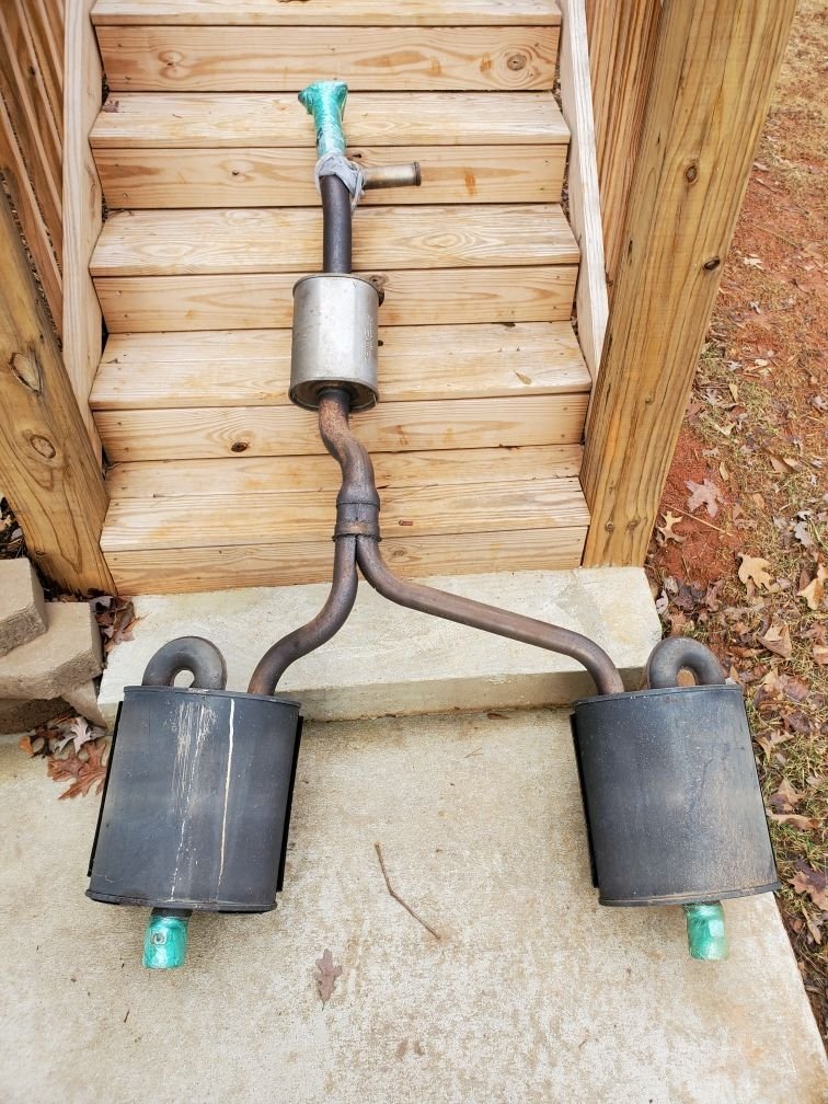

Here is what I bought.. The guy (from on here) was good enough to shrink wrap the ends to keep stuff out, he said it had about 66k on it.

Thanks for the measurements.
For the standard noise test (used by California and wannabe states for legal testing and by many users to compare exhausts like we're doing here) the microphone used in the test should be level with the center of the exhaust outlet (but no lower than 8" off the pavement) and 20 inches away from the outlet at a 45° angle outboard of the vehicle so the exhaust isn't blowing directly on it or getting reflected noise off the body work. Warm engine speed of 75% of WOT (6000rpm for an AP2 engine).
If your measurements were taken like this 91 is less than my Tanabe Medallion and "not too loud."
The new-old exhaust in your photo looks like an AP1 exhaust. Round tips and round whatever that thingie midway between the cat and resonator is called. Darned if i can remember what it's called. These are both oval on AP2 exhausts. Should work fine. You'll probably have to fiddle with the rubber hangers which are auto store as well as any Honda store.

Are you saying the mufflers or the tips coming out are oval or both? He said he had it on his CR for a while, what ever that means. Cost me $110 and about 60 bucks for gas so I thought it was worth a chance. I'm hoping my chrome tips fit on it as well as it came with no tips. It all seems to be in good shape.

The oval Helmholtz resonator was on '06+ years. '05 and earlier were all round.
The ap2 exhaust has more robust hangers, which aren't visible in these photos, and while the tips are same/similar, they stick out more ap1 vs ap2, due to differences in bumper shapes. Its the pipe off the muffler that differs in length, not tip itself.

I've never seen a CR exhaust off the car but this sure looks like a 2000-2003 AP1 exhaust. No matter, it will work.
Helmholtz resonator is what the thingie is called. Round pipe-like thingie before 2004 and oval afterwards. AP2 exhaust has the oval "Accord" tips which fit under the oval shaped bumper cutouts. AP1 and almost every aftermarket I've seen are round. Tips are available on Amazon and the OEM tips show up here from time to time.
Oval tips. Oval tips.

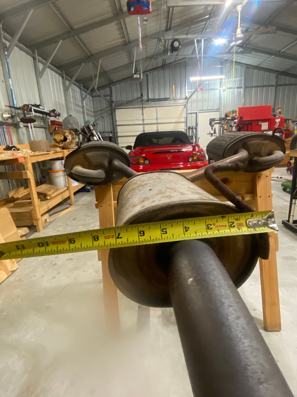

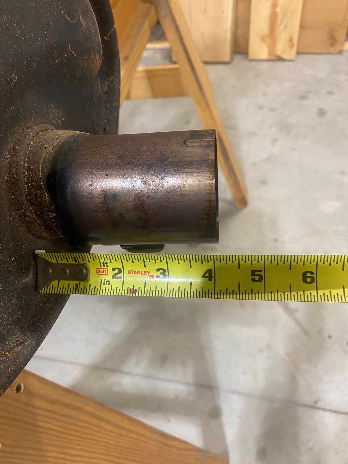

Ok, you guys were discussing things so I went out and took some more pics.. maybe we can determine what this really is off of. Unfortunately the chrome tips on my current exhaust are part of the mufflers so I'll have to track tips down along with the proper front "gasket" .
Sorry about the gynormous pics!
The exits from the mufflers are definitely round
And the resonator is definitely oval
Looks very clean inside

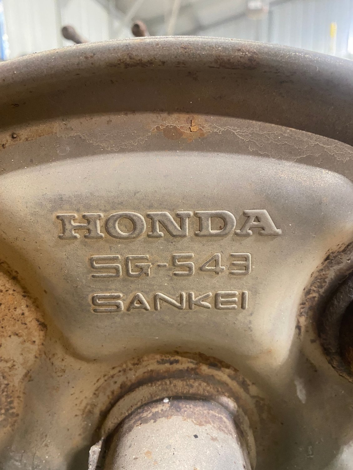

And the markings on the front of the mufflers

Quick google search shows the SG-543 was for the AP1, not sure how accurate that is. I've never looked at my AP2 exhaust to see what it says.
