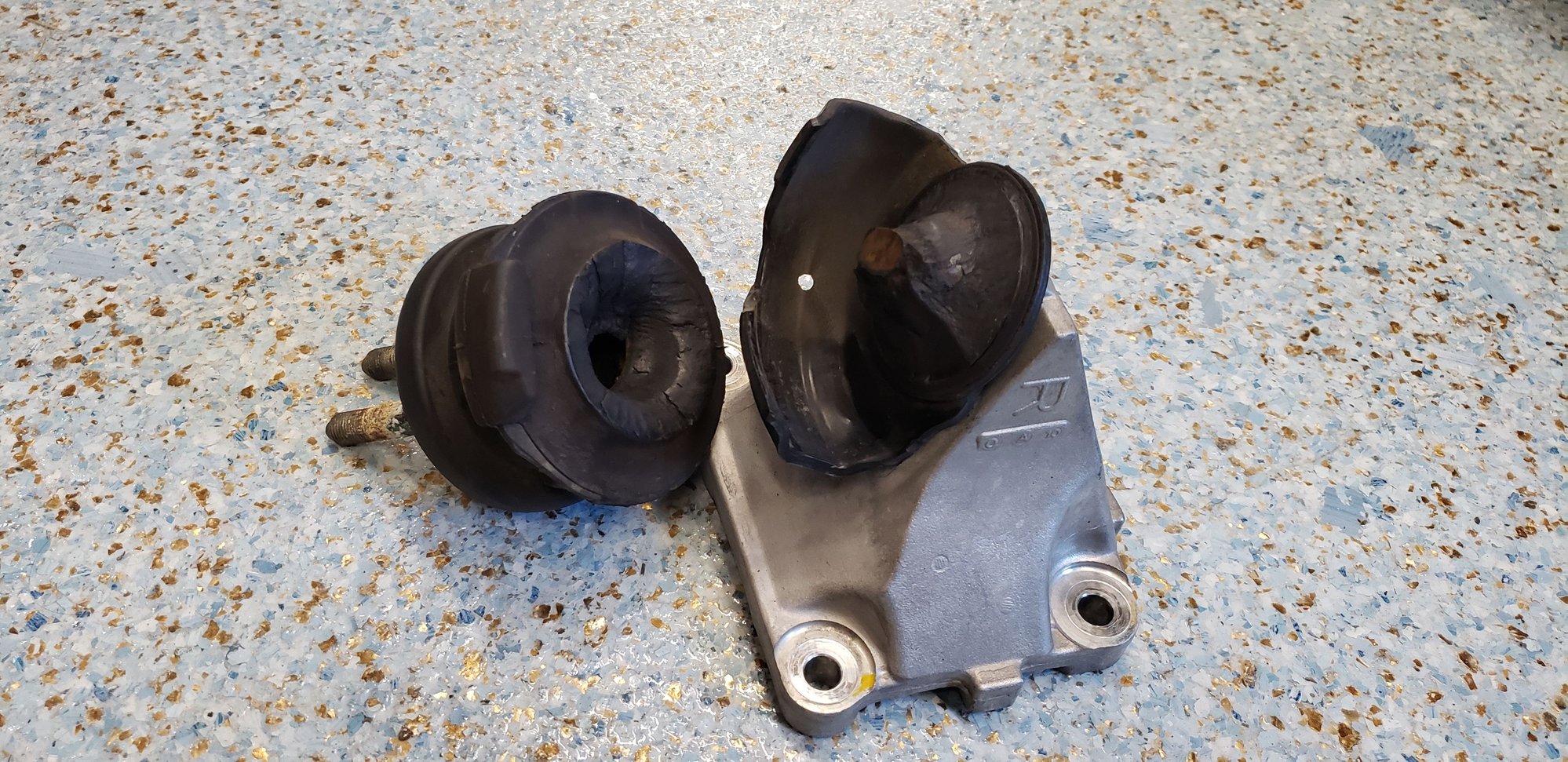

Originally Posted by TR25
Sorry to hijack this thread, but how would someone know if their motor mounts need replacing? Visual? Audio?
If you look closely at the RH side one, you can see if it has collapsed. But you need a good one to compare it to to actually notice. LH side is hidden so its hard to see.
If your mounts are OEM or OEM style hydraulic ones, you catch it early enough after it breaks, you'll see a brownish liquid oozing out underneath the mount.
The engine response will also feel less fizzy and more lazy and you might get more cowl shake or rattle over bumps because the engine is flopping about a little bit.
In general, if you drive the car hard and/or have like 75-100K on it...at least one of the mounts is probably torn, assuming they're the original ones.
This was my RH mount. It only looked slightly saggy when installed on the car and it was hard to tell for sure it was broken. But its VERY obvious when removed from the car. My car has just over 100K miles. But this mount has been torn for a while.
