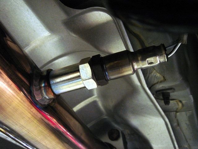

I have the Berk test pipe. The cel was off for about 100 miles. Now its on and damn, is it bright! I am now in the process of installing a o2 simulator, electronic. Purchased from summitracing.com. Its by Caspers electronics, part # 104037. Hope it works, That light is damn annoying.. Its like my buddy says that installed the t-pipe for me "Now you've got a $30,000 sports car with a check engine light." Some people can live with it. I cant. Guess I am too manic!! The pipe does provide some gains though. Thats why I am doing what I can to keep it. Otherwise, look for it in the FOR SALE section, cheap!!! Will keep y'all posted.

Update - just pulled the positive battery cable to reset the ecu and the cel is noe off. Dont know if this will last. Posted the question in UTH.

Did you check the code to see if it was test pipe related or were you just guessing it was?
