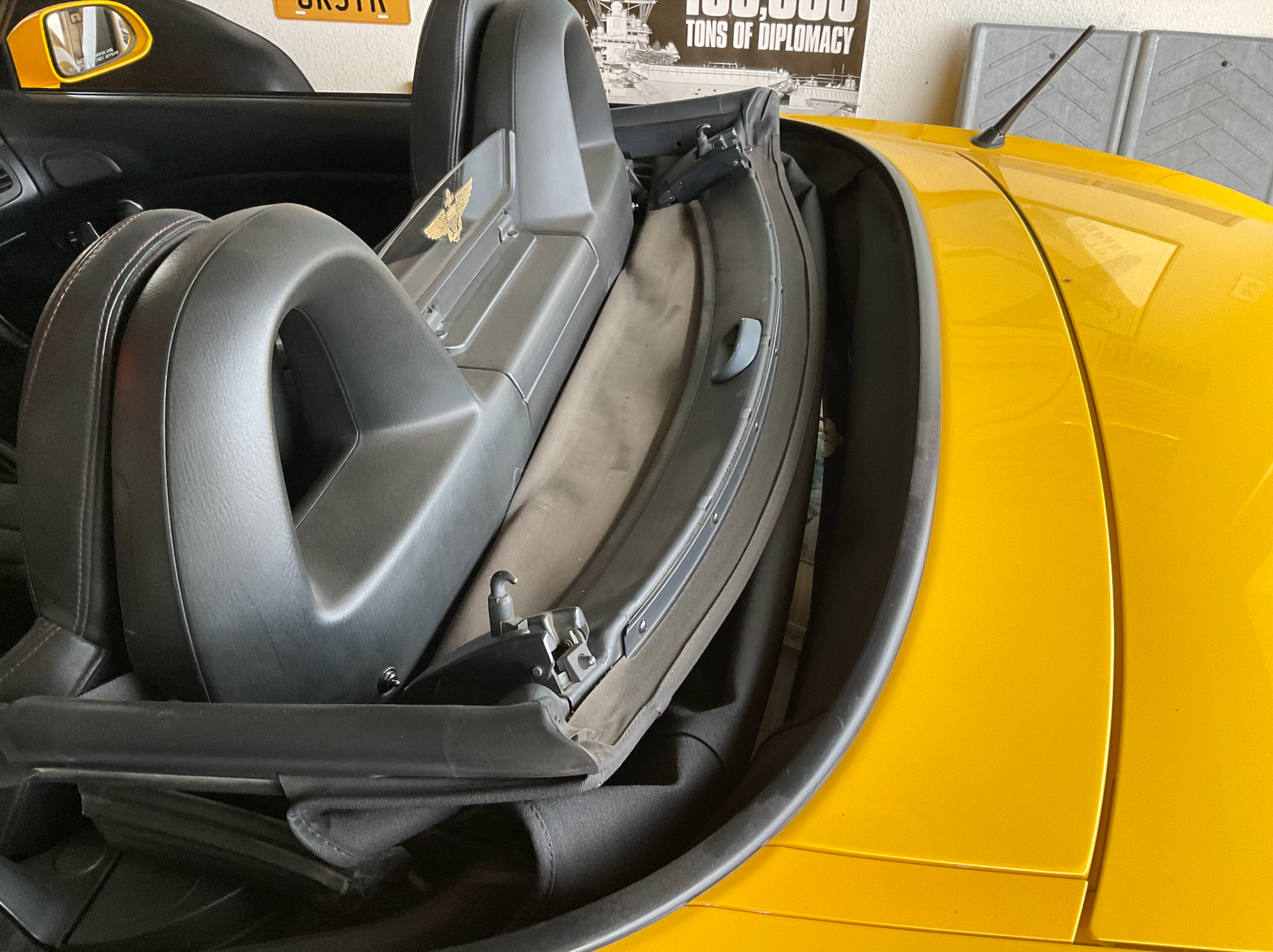

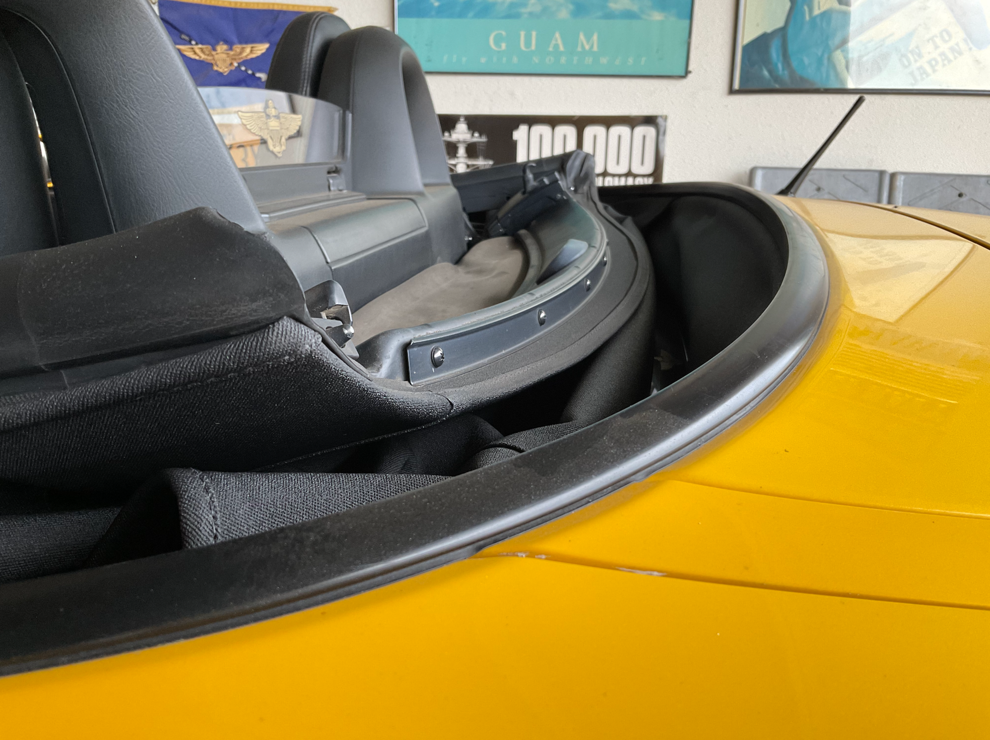

When my top is folded down this is what it looks like. Easy to get my hand under and pull the snap with a little push from above. I might add I have a thick Thinsulate layer on top of the plastic rear window shelf and it still compresses this well.
