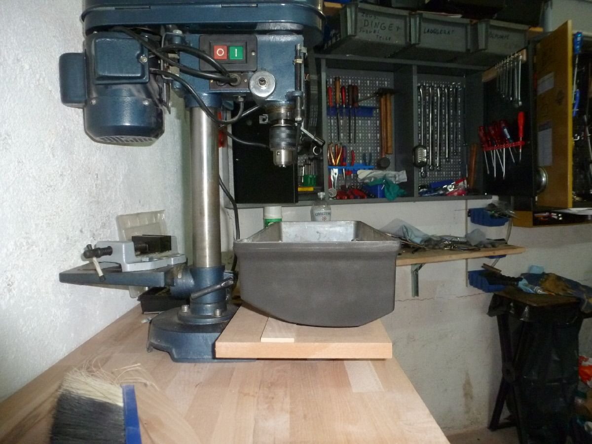

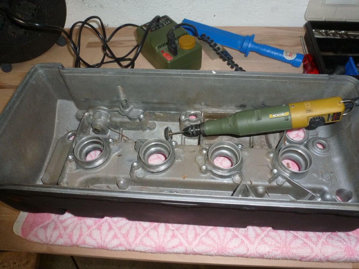

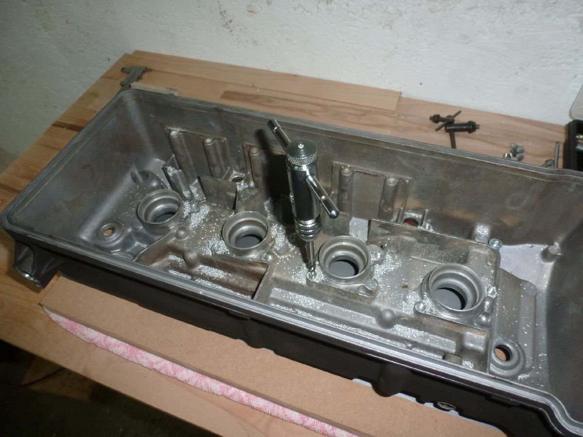

The modification of the Valvecover just need basic metall working skills and a drill press. But the difference it is not noticabale on a street car. If i find the time, i wlll try my own version 2.0. My impression is, that the PCV system is more a "oil sucking System" on this cars. No wonder honda has changed it on later modells.
