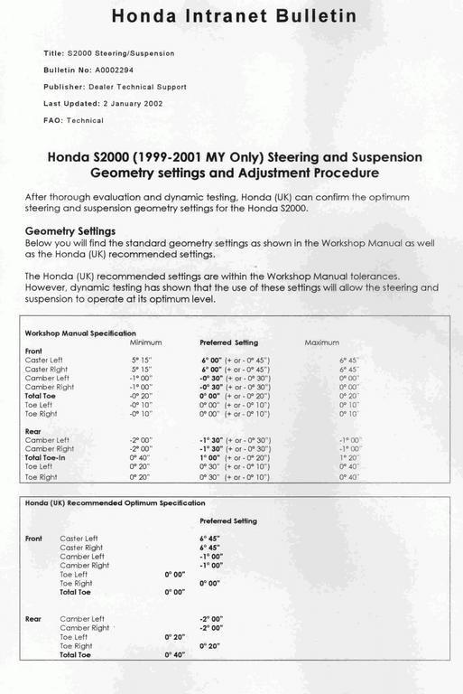

UK TSB Wheel Alignment Recommendations
Honda UK settings are published in degree/minutes and some machines take inputs in decimal degree which is translated by = sign.
Camber
Front -1 deg 00 min
Rear -2 deg 00 min
Caster
Front 6 deg 45 min = 6.75

These are the settings which I have applied fairly recently - this is on a MY00. Overall, the car feels more 'seated'.

Thanks for the actual UK TSB scan. It's nice to see the actual document. BTW, I would think it would be a blast to do the turning circles at the straight line speed limit
