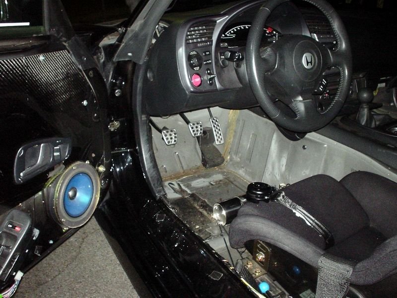

-25 Spare Tire
-2 Trunk Trim
-7 Tools/Jack
-1 Mats/Visors
-30 (1/2 tank gas)
-12 Optima Battery
-15 Recaro SPG/Taitec rails (per seat)
-5 Center Console
-10 Stock Rollhoops/Plastic (I have an aftermarket rollbar)
-2? Washer Fluid
-1 Alum Pulleys
-30 Wilwood Brakes
-15 Interior (sound deadening, carpet, door panels)
-18 Tein RA Coilovers
-33 Exhaust if you replace with T1R single
-12 Header
-11.5 Airbags (5 pt. harness makes them obsolete)
-10 Catalytic Converter (Replace with T1R straight pipe)
-5.5 Cruise Control unit and cable
-35 AC plus AC radiator/fan & lines
Volk CE28 Rims:
17x7.5": 13.8 lbs
17x9.0": 14.8 lbs
Stock '00-03: 17.5 & 18.6 lbs
~300lbs
I wouldn't remove the Overflow tank for the radiator--it's there for a reason and no way does it weigh 15 lbs. It should never have more than about 24 oz. of coolant in it, so it doesn't weigh very much more than a medium sized bottle of Gatorade. The Cruise control isn't mostly electronics, btw--you need to pretty much break the cable off the gas pedal, so I'm not sure how reversible it is.
Alot of the weight savings I did were free and though the car isn't really legal, it's still safer than stock. Everything that wasn't free was purchased for a reason other than weight loss. That they also decreased lbs was an added benefit. Lesson is: do your research before you buy anything--the Tein RA and the BuddyClub dampers are equivalent in terms of performance and cost, for instance, but the Tein are almost 5 lb. lighter per shock. Stock Bridgestones in 205/225 16s weigh just as much as 235/275 17" Kumhos.

Stock head unit and speakers are actually pretty light, considering. I took them out only to find that the weight loss (~6 lbs) just wasn't worth having to listen to only the singular drone of the exhaust.
Stock steering wheel has been replaced with a Sparco quick release, since that last pic was taken, too!
