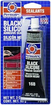

I bought some 1680D fabric and cut out test patches to glue together using various glues. I let them all dry overnight before attempting to pull them apart. All of them I was able to pull apart except for one.
[Permatex]
The fabric has pretty much bonded together and I was unable to separate the two pieces I glued. Make sure you glue the glossy coated side facing the roof.

Practical question: How did you get the adhesive all the way out to the edge without making a huge mess of it?
I bought it on eBay. It came in a roll so I have some left over.
I cleaned the surface area with rubbing alcohol and let dry completely before applying the patch.
I placed a cardboard box on the floor of my garage and held down the patch while I covered the entire surface facing up.
Then when it was fully covered walked over to the car and applied. Some squeezes out to the sides but you can wipe it with your finger along the edge of the patch. I must of gone through like 30 latex gloves during the process lol...
I sewed mine and used Black RTV silicone. The patches held up very well with my top going up and down daily.

Thanks for bumping this scottdh20. I spread some of the Permatex RTV adhesive on the backs of my Black Hole patches that lost their adhesion and stuck them back in their original positions on the inside of the top. 24 hours later they were stuck. I mean, REALLY stuck. These things aren't coming off without taking the top material with them.
Overall, totally satisfied. In the colder weather the adhesive solidifies a tad, but that's fine.
