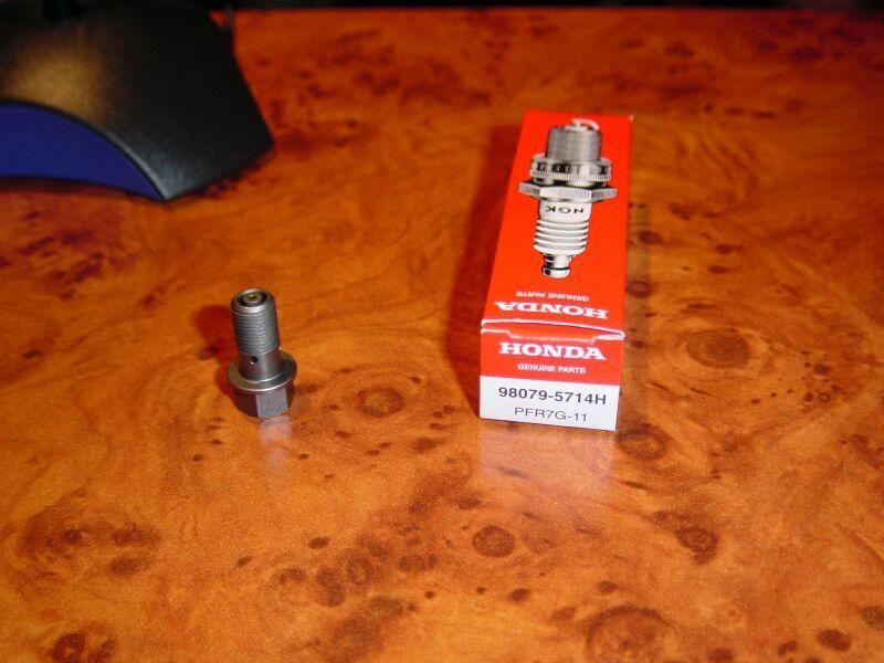

I don't know the VIN# for the oil bolt change, but the last engine with the old style oil jet bolts is 1025386. You can find this number either on the engine itself right after F20C1 or on the dealer's invoice from AHM. The dealer can look it up for you. The change over occured sometime in the spring or summer of '02.

If you want the full scoop on this, do a search on "oil jet bolt" or "banjo bolt" or "European recall." 'These are not "head bolts." They fit underneath the pistons and cause oil to spray on the underside of the pistons and lower cylinder walls.

It costs about $250 or $300 to have a Honda dealer upgrade from the old to the new oil jet bolts. We have no real evidence that this makes any difference. I did have my dealer do the change over.
