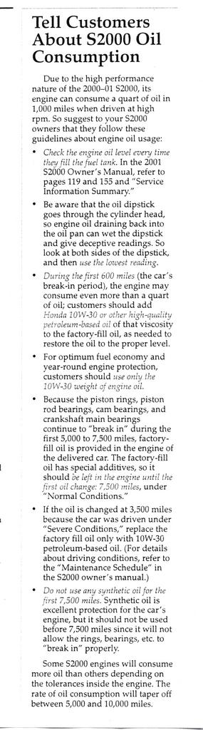

Dealers really need to be telling owners this. Your first oil change should be at 7,500. See details below.

6 months or 3750 miles. my car hit 6 months but only had ~2000 miles so i changed it anyways. the oil was very black and dirty, im glad i changed it out. i also don't vtec my car everytime, maybe once a day or something. now that the first oil change it out of the way, im going to change the oil at 3k miles or 3 months, whichever comes first. i work at the honda dealership and can change my oil with free parts(free castrol gtx, oil filter and washer), so it doesnt matter for me. the f20c needs maximum protection when its at ~9k rpm and hving fresh oil is a great idea.

That bulletin is only for the first oil change which shouldn't happen until 7,500. After that you can change it as often as you want. The first change is the most important with "OUR" engine due to the break-in oil.

The bulletin also says or 3,500 miles if drove under severe conditions.

Severe conditions are stated in your manual. I think everyone should read it over. It probably doesn't effect most of us unless you drive like a bat outta hell everyday (9,000 rpm) in 110 degree heat. That's mainly for Canadaian owners. They are recommended to follow the severe conditions portion due to colder temps, dusty/de-iced roads, etc.
