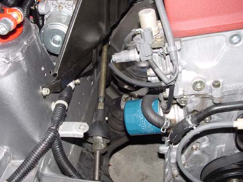

Will the Speedcraft Turbo fit RHD?
Old Nov 28, 2001 | 05:20 PM
AusS2000's Avatar
Posts: 30,809
Likes: 15
From: Sydney
Default Will the Speedcraft Turbo fit RHD?
The steering shaft is on the left (looking into the engine bay) and probably interferes with the turbo manifold.
Derryck, ChrisD?
Old Nov 29, 2001 | 09:06 AM
ChrisD's Avatar
Posts: 811
From: Tampa
I don't know a whole lot about how they mounted it, but just judging from that picture, the turbo would go right where that steering shaft is. So I don't know if it's a feasability for RHD cars, but that's just a guess. Demand is already pretty tempered as it is, so I don't know how much money, time and effort speedcraft would be willing to put into an RHD version.
