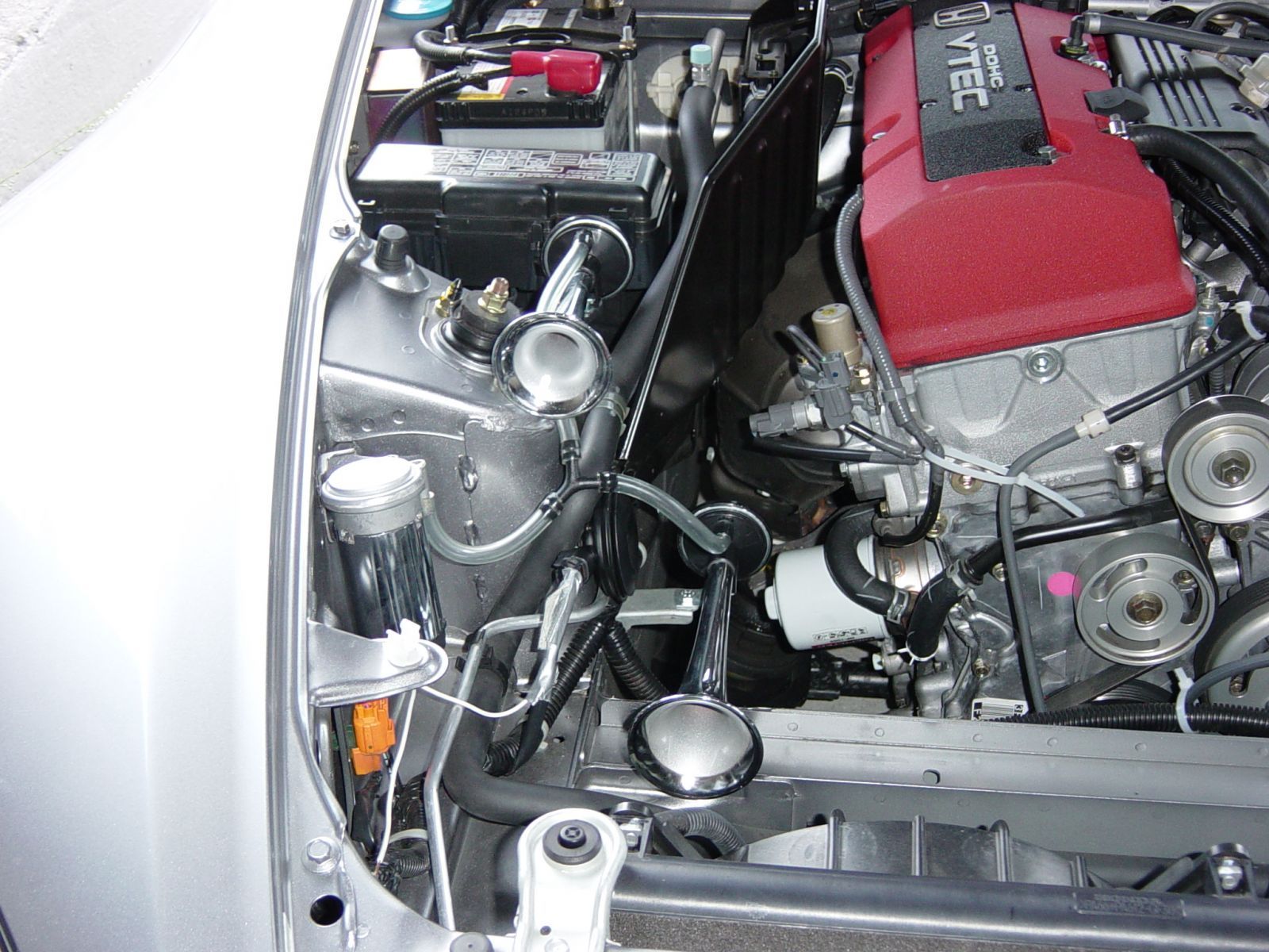

These were requested by mikes2k....
I have an '03. I mounted the compressor where the #2 horn is mounted by honda on the '02's and up. I moved the Honda horn to the bolt the holds down the leading edge of the heat shield. The hi pitched horn is mounted in an empty hole in front of the fuse box. The lo pitched horn is mounted and a bit that holds onto the stock airbox. I spliced into the stock horn's power so I get both horns with a push on the steering wheel. It was late and I was tired when I finished this so the wiring is hacked right now, I plan to rewire with heat shrink tubing and run some slack to route it cleaner......

Look great. I have them installed my mine too. I love to see the car jump right back in their lanes when they are changing into my lane too close. they think you are a semi that they did not see.

I just put my FIAMM triples in a few weeks ago. Mounted them where the AEM CAI would get it's air. Left front. I plan on going comptech so it wasn't an issue. I love these things. They are so friggin' loud!

What?! MY '02+ has an additional horn? This is the first I've heard of this, how cool So, does it change the sound or the volume? Is it still a meep-meep?
