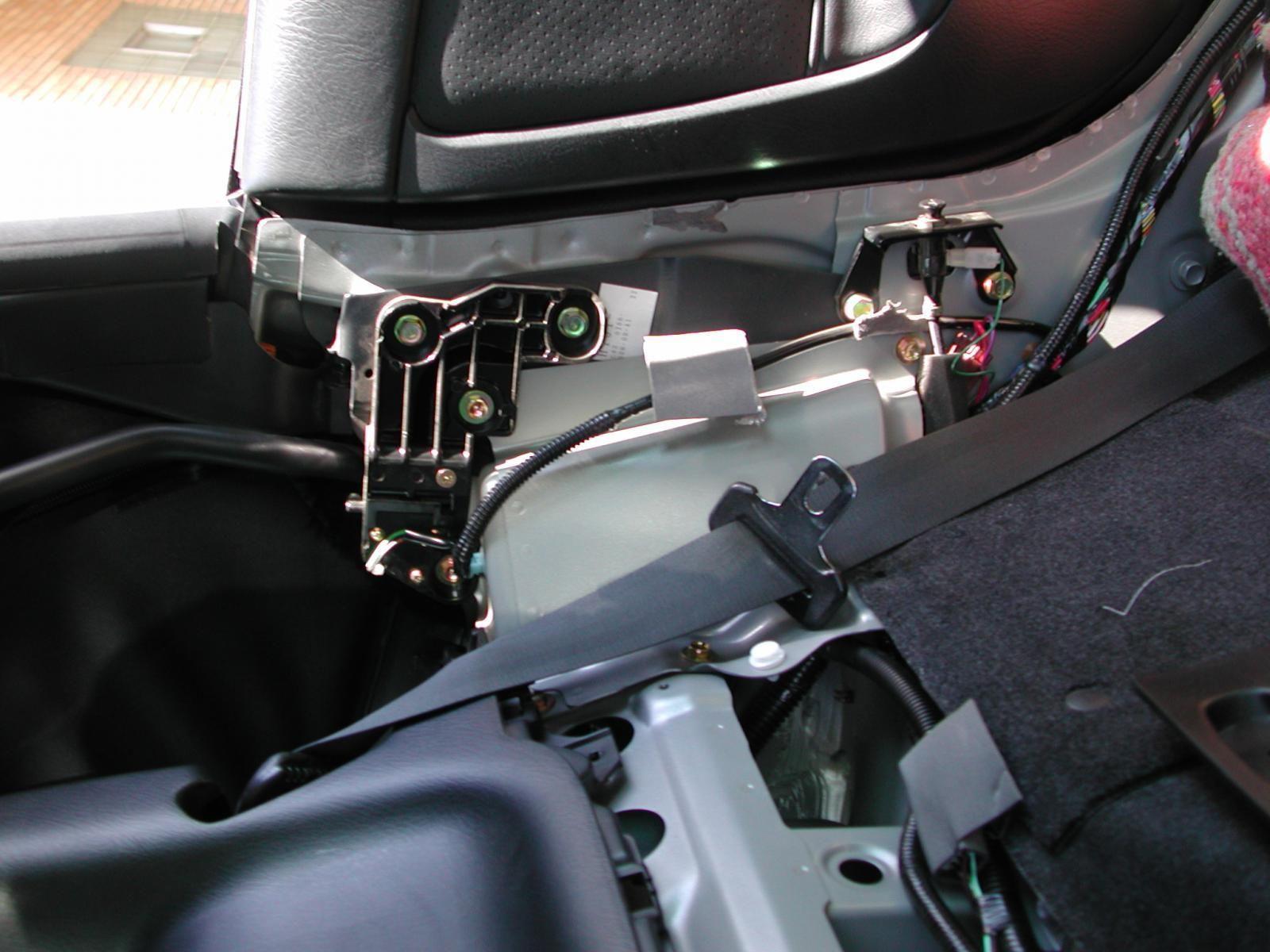

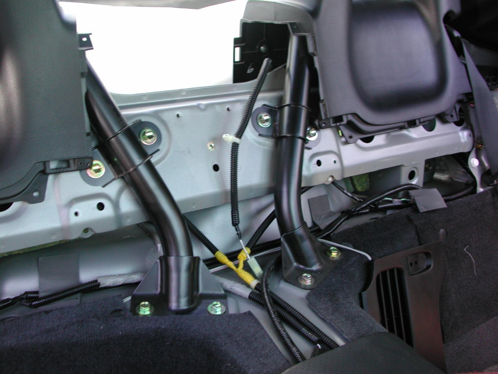

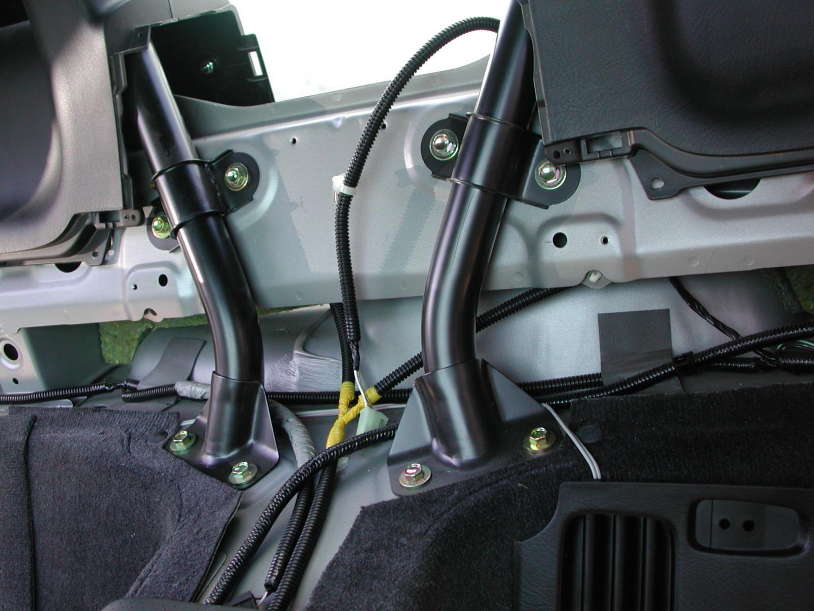

Barry in Wyoming's Avatar
Posts: 4,762
From: Sheridan
Old Apr 8, 2004 | 06:49 PM

Good pics Barry. And yes, the seats are a spacial issue.to get to everything.
