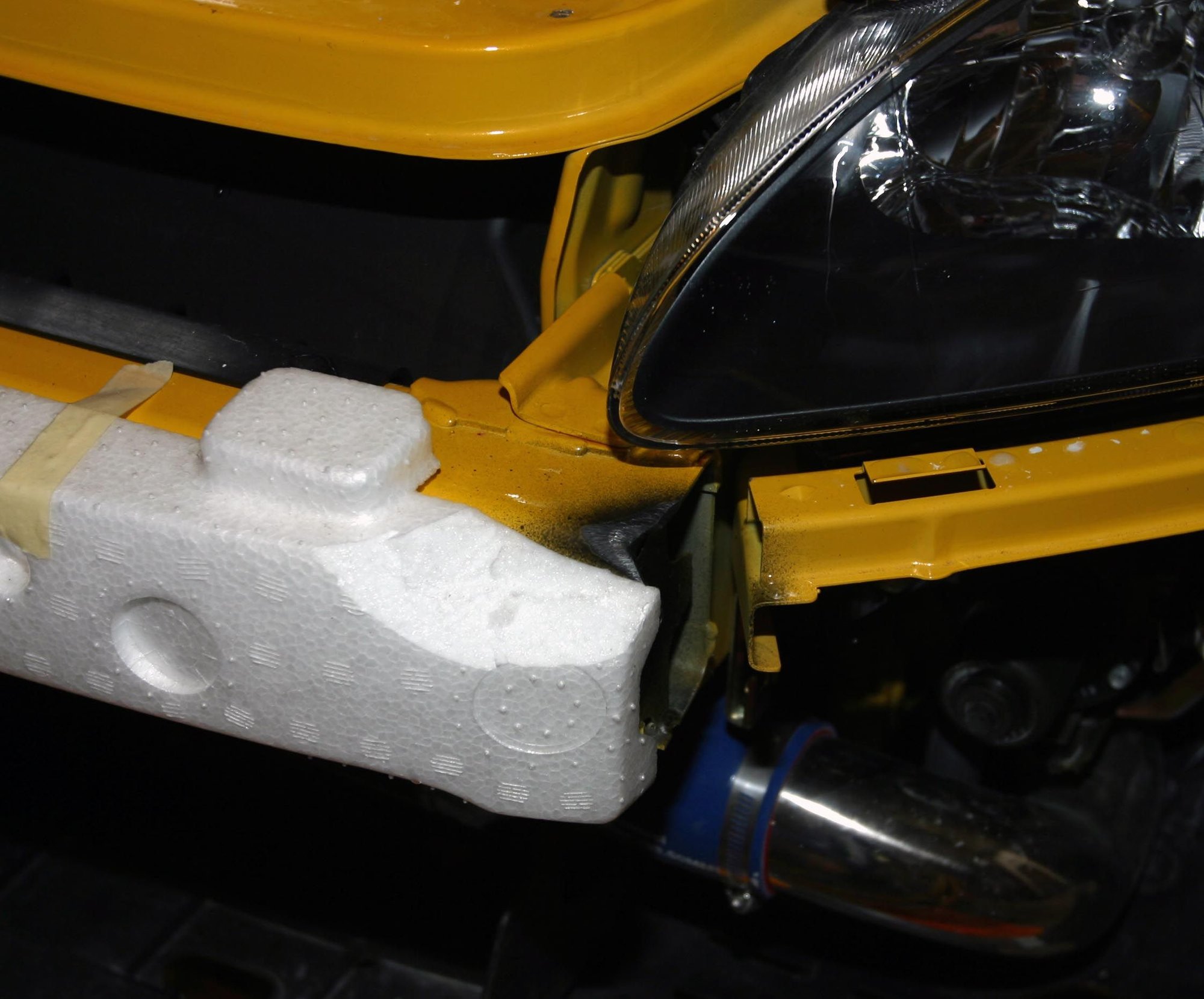

Something to be aware of:
I have been told that the '04 bumper doesn't quite clear a couple of hard points on the frame. After a while, dimples will show through to the outside. Contact Poindexter about this. He has photos that show this. You have to grind something down to ensure this doesn't happen. Here is his "how to":
http://forums.s2ki.com/forums/index.php?showtopic=186184

This picture shows where you have to grind. Needs to be done on both sides.

Thanks XViper and fperra.
