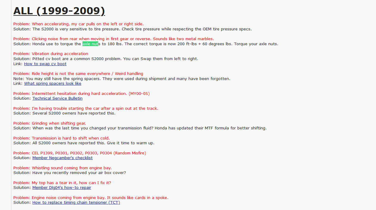

That sounds like your axle nuts are clicking. There is a TSB on those.
"Solution: Honda use to torque the axle nuts to 180 lbs. The correct torque is now 200 ft-lbs + 60 degrees lbs. Torque your axle nuts."
Edit: I should add that mine have been doing the same thing for about a half decade now without any side effects. It would behoove you to get them retorqued though.
Where is this from???
200LB + 60 degrees?
RIP that poor axle stub.
200LB + 60 degrees?
I pulled that from the "common problems" sticky post. If that's not correct then someone needs to delete that bit.
The Billman recommended method is 150-180LB + 60 deg.
Obviously, he knows what he's doing...but as stated above...in a post started by a guy who broke his axle...Billman stated its Original staked position + "feel" when its tight enough. The 60 degrees is just a guide.
