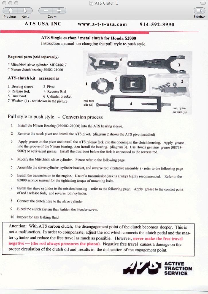

Look like this?
Old Oct 29, 2010 | 02:37 AM
James Rowe's Avatar
Joined: Oct 2010
Posts: 108
YES its identical to that. I made a new peice where its snapped. It works but the clutch is slipping everywhere. It only engages at like 5k then slips and bites. At times it will bite straight away and at others slip to hell and back.
Any ideas? Really getting on my nervs. Tried adjusting the legths of the rods but makes no difference! Its like its contstantly pulling on the leaver connected to the gearbox, is that leaver ment to spring back because it doesnt...
Also, slow2k is that a honda s2000 pull clutch cylinder setup?

If it helps I have a Carbonetic Clutch and Flywheel...

Sounds like you need to contact Carbonetic for replacement parts. You may have damaged the clutch disc when it broke
