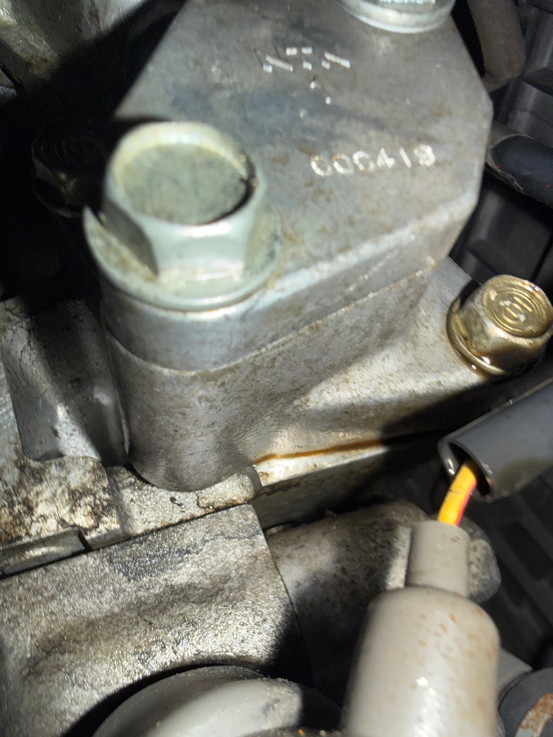

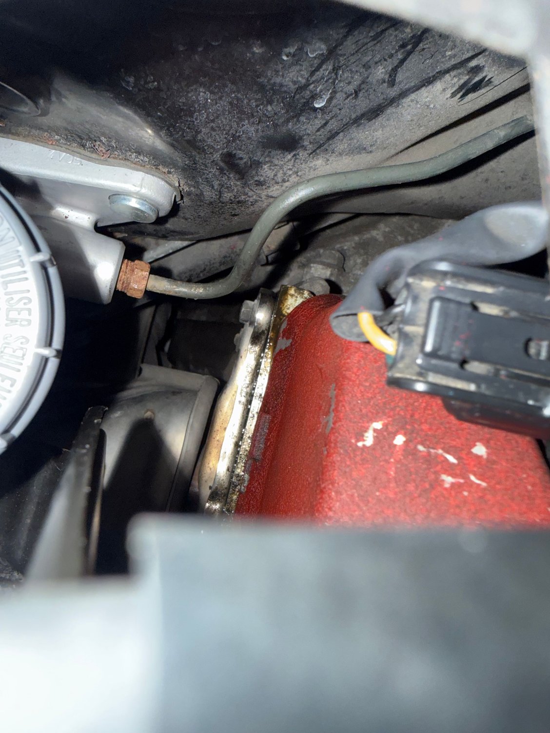

Apologies for the lack of responses; I’ve been busy with work. Finally, I had some free time today and swapped the map sensor, hoping that would fix the issue. It did not; the car does feel somewhat smoother, but my issue still persists. I also sprayed carb cleaner around the bay to check for vacuum leaks, but nothing there either. A note to add, I have already replaced vtec solenoid gaskets. I did find a leak from my Timing chain tensioner(TCT) and rear of valve cover. Will be ordering new gaskets and TCT maybe one of those is my culprit. Can see the oil spilling from the bottom of tct and bolt head
This was after I wiped it down before a 10 minute test drive

sounds like the car is running overly rich, that will kill performance as the car runs rich in factory form when perfect. Perhaps the two sooty plugs are an indicator for the rich running cylinder. The fuel injectors may not be spraying properly causing a rich condition with unburned fuel. I would run a bottle of Redline Fuel system cleaner, cheap and easy, and it is one of the few products that works. A valve adjustment / check would be a good start as well. check the spark pug gaps, make sure they are within spec (1.3mm or less)
