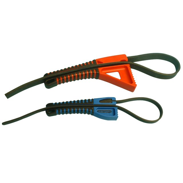

Well, seeing as I was rubbing as is, I didn't want to wait to have something shipped to me so I went to Sears to see if I can find a spanner wrench.
I couldn't find a spanner wrench but I did find these that turned out to work pretty good for me:
They had a sale on the 2 piece kit which I'm really glad I bought because I ended up using both. I used the larger one on the collar and the smaller one to hold the sleeve in place. Worked like a charm
After test driving, I'm still rubbing a little bit on larger bumps and dips so I have a few more adjustments to make, but thanks again for the help!
