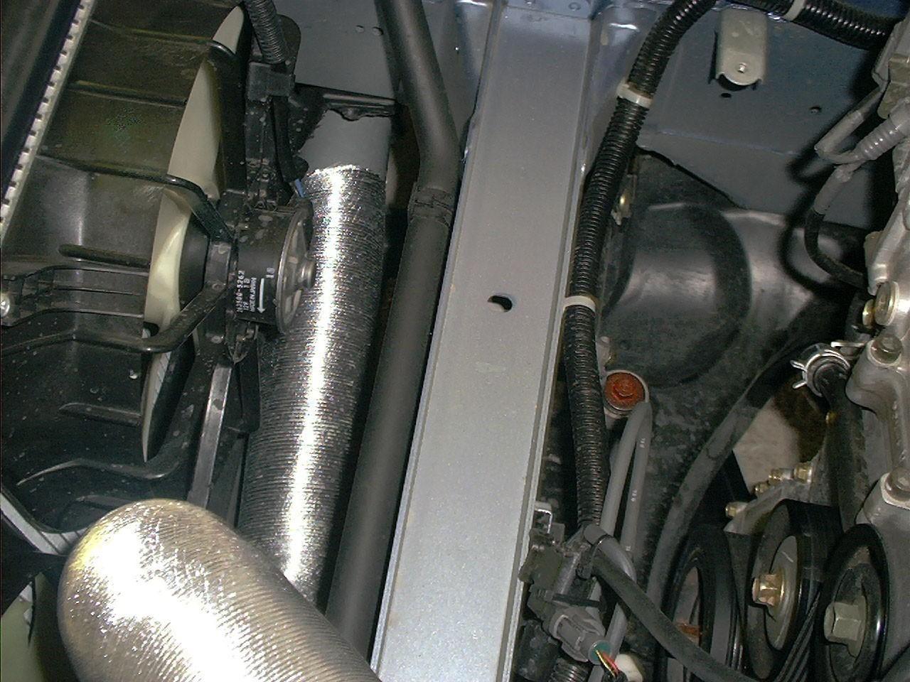

I have an AEM in my '02, and love it. I really don't think it cost me any power, but I don't think it gave me much either. The best thing about it is the sound. I put an insulation sleeve over it to prevent the radiator from heating it, installed a Hondata insulator / gasket between the head and intake manifold, and installed a Mugen Thermostat / Thermoswitch / Radiator Cap. These mods together make it run a lot better when it is hot outside. It is over 90 degrees here right now, but the car runs like it is in the 60's.

Can you take a photo of this on your car and post it here, please?

I took some pictures on my digital camera, but I can't figure out how to post them. I'll have to investigate it later.

The sleeve has some sort of fiber on the inside and reflective foil on the outside and is just a tiny bit larger in diameter than the AEM pipe. I got it from another S2000 owner (TypeSH), so I'm not sure where to buy it. He paid $10 per foot for it, and it only takes about 3 feet. It only took about 20 minutes to install it.
