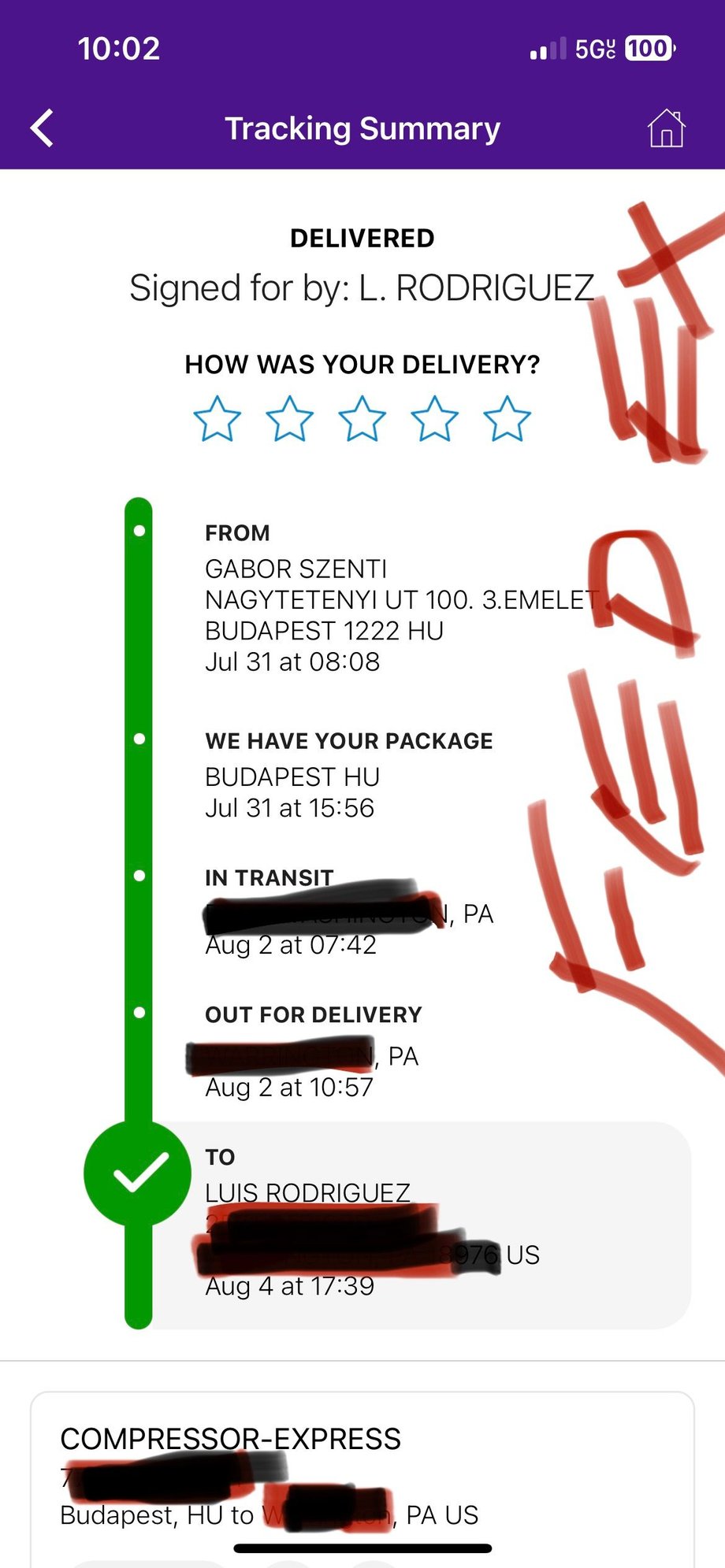

yes! received it in 3 days! fast! looks great matches up to the oem cause it is a perfect match! i might have a pic to post here. ill post it tomorrow old used oem with "new" one from the site. not ready for the swap yet cause im in middle of a sleeved block swap.

Old Aug 21, 2023 | 02:19 PM
