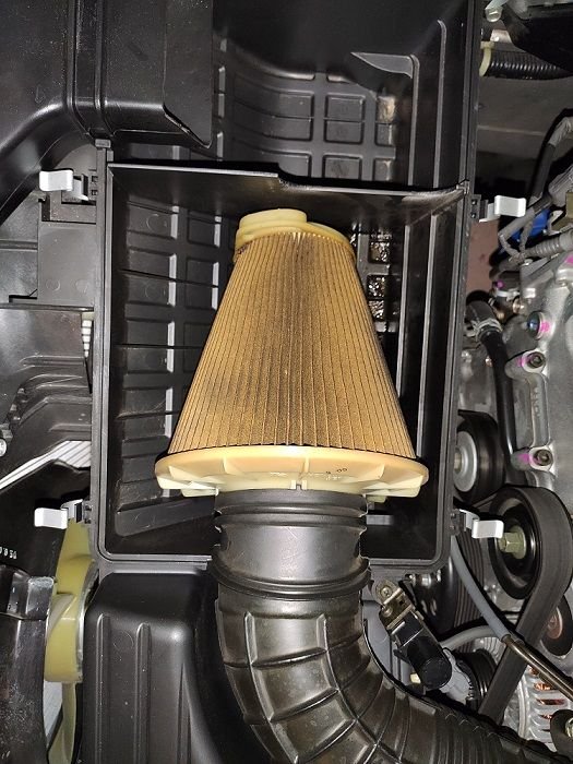

Hi all,
New to the S2000 world, I was messing around under the hood and wanted to know whether I have the OEM filter in there or an aftermarket, only asking because I saw traces of oil at the bottom of the pan. Also does it look like it requires changing? Car is a 2005 with 23K miles, so I am assuming it was never changed?
Cheers.

Yours looks generic. The ones I'm used to seeing are either green (2000-05, 17220-PCX-003) or blue (2006-09, 17220-PZX-003) filter material color.

Oil can slosh into the intake tube. Some of it will go into the intake manifold and then be burned in the engine. The excess will flow the other way and puke from the filter and end up in the airbox.
It looks like a regular OEM or OEM style filter.

Yours looks OEM and very old. I would change it. I recommend K&N, my car is 18 years and lows miles like yours.

I will go for the OEM, going to pick one up today. The one I have looks like the premium guard one for sure. I am missing the ring that holds the rubber 'hose' onto the filter housing, hope this will not be a problem.

I just took out, it was an OEM Honda filter after all, old, maybe weathered? The new one is a bit more greenish, surprising amount of oil under the filter. There was no steel ring holding the filter in place, but it was very snug none-the-less, so I do not think it needs it.
