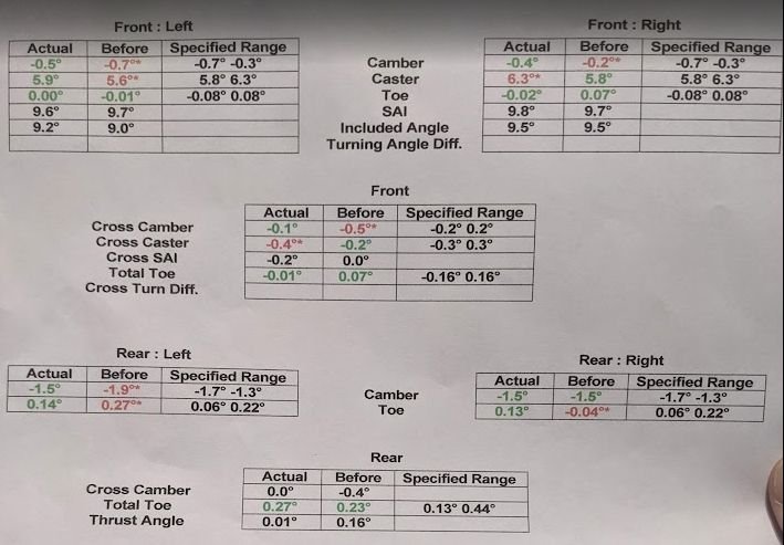

I just had ExtremeContact S02's installed on my 09 AP2, everything is stock steering/suspension wise. I don't drive the car much (500-1K miles a year) but how do these numbers look? The tech that did the alignment didn't seem like he was confident in his work when he was talking to me afterwards.

Looks fine

The caster is the only thing thats outside of spec...and its outside in the positive direction, so no huge deal.
Maybe your caster adjuster was frozen
Otherwise it looks fine. Like a stock spec alignment.

Its normal for alignment techs to put a little more caster on the right because most U.S. roads slope to the right. That little bit of extra caster compensates for that tendency to tramline towards the drainage slope.

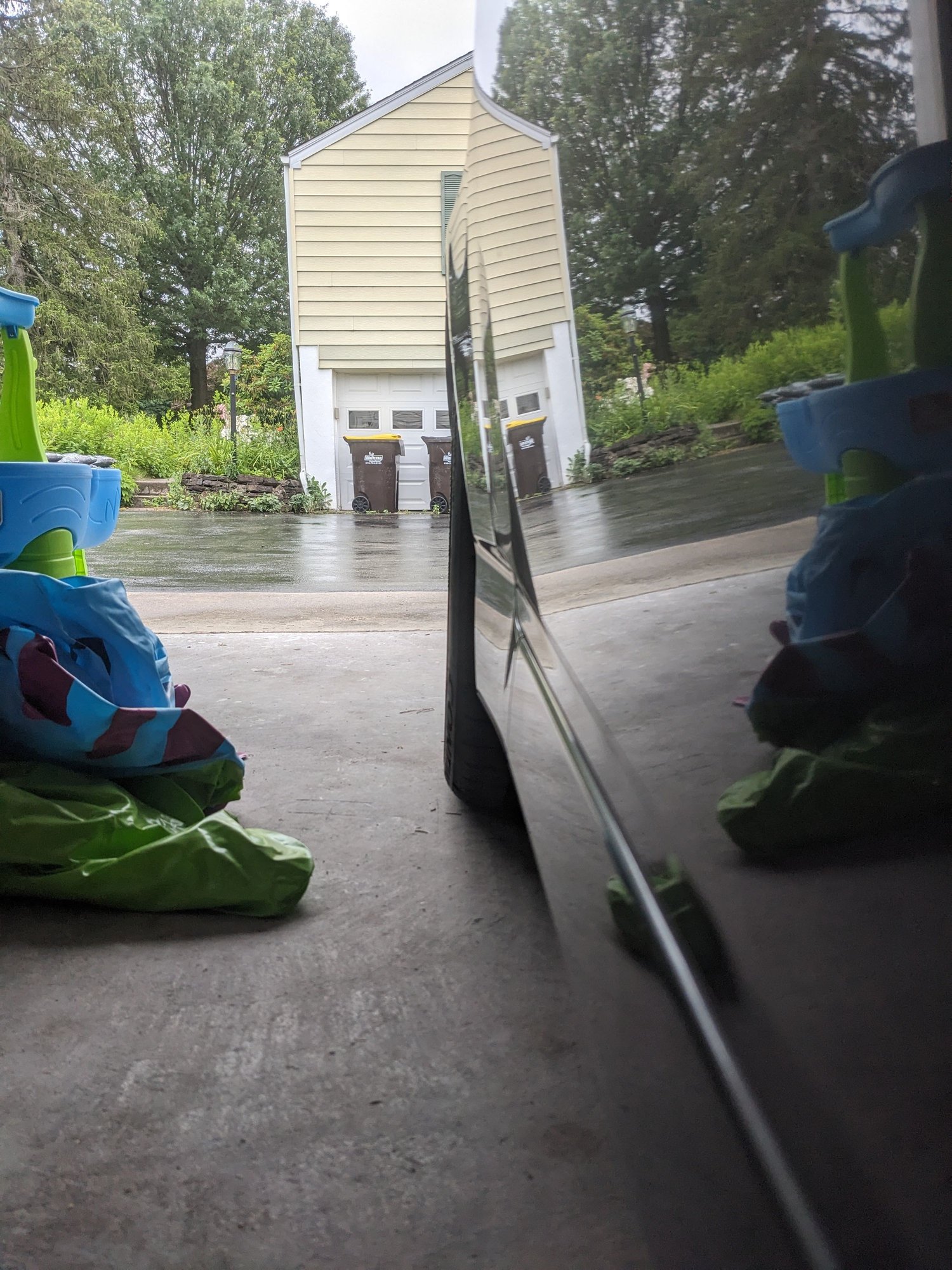

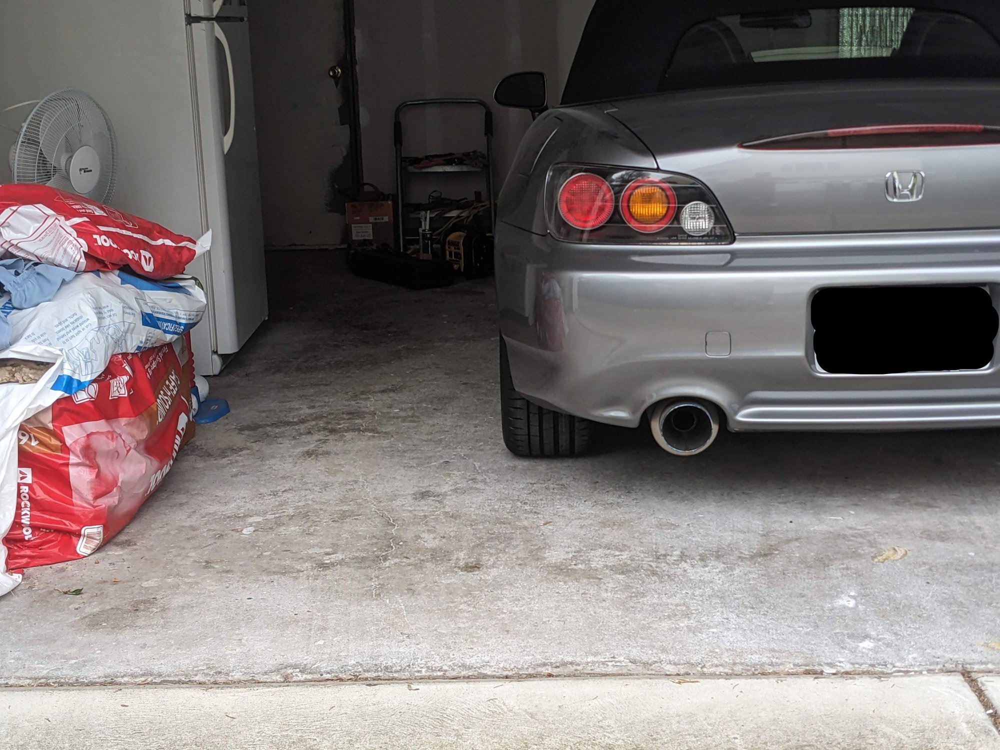

Since the alignment was done, I've put a whopping 2.2 miles on the car (shop > house). I looked around at the wheels and noticed weights were stacked this time instead of next to each other. Obviously not at risk for hitting the calipers or anything but is that normal practice or just lazy work?
The back right wheel seems to be noticeably more angled in that the back left. I'm parked on level ground so I'm not sure what to make of that. If the camber and toe are almost identical in the rear, what would cause the visual mismatch?

Seems sufficient for a non-track alignment.
Most people run more front camber if possible if you're driving it really hard, otherwise don't even worry about it. (You'll know you need more front camber if you are wearing away the outer edges very quickly. You could also slow down before taking the corner too.)
If you want live action roleplay track-focused alignment, you want somewhere around here:
-3.75-4 camber front
6 deg of caster (will likely be impossible to do without offset ball joints)
0 toe
-3 rear
.40 deg total rear toe

Does anyone else think the back right looks off compared to the left?
