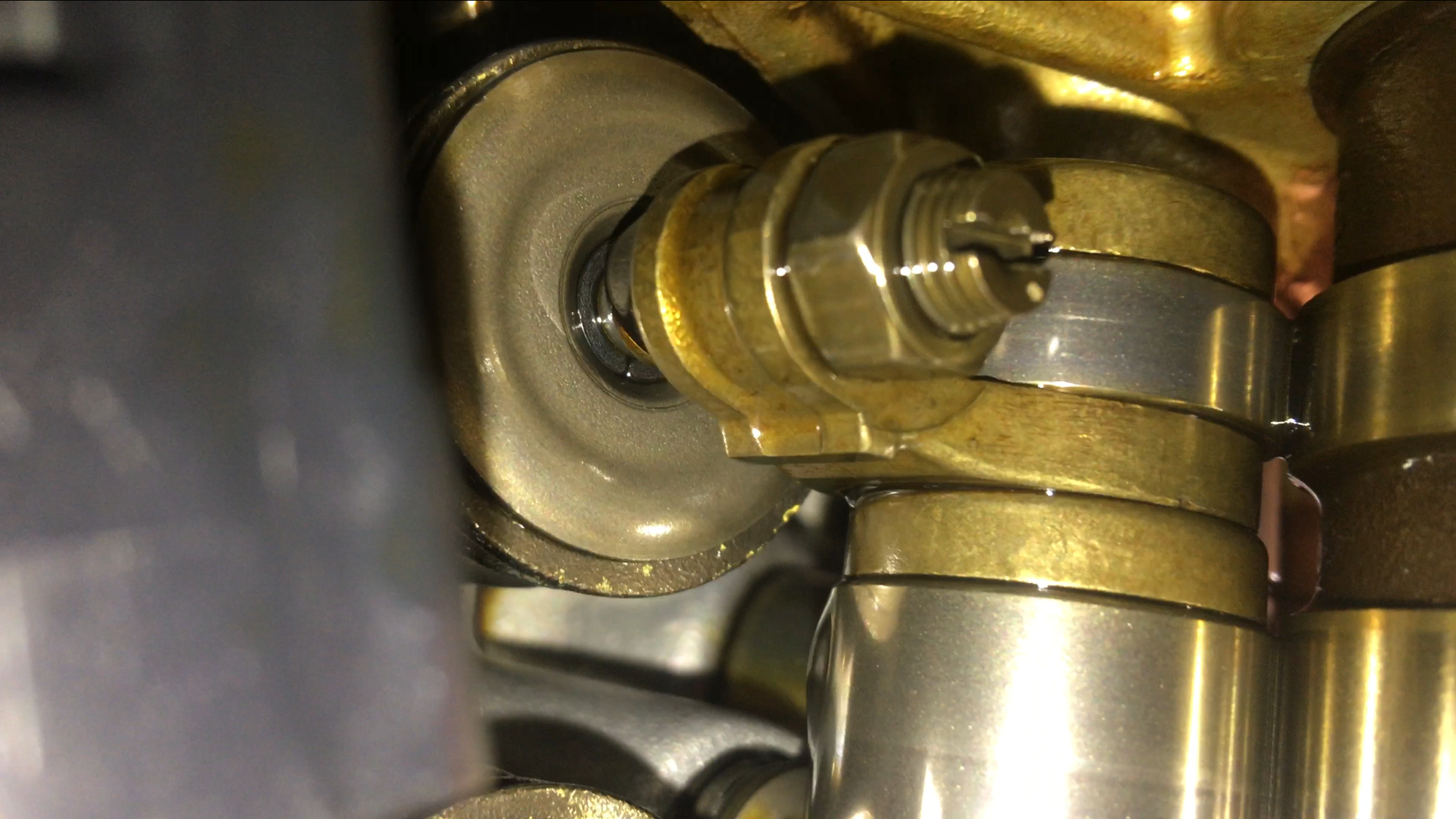

AP2 intake retainer on AP1?
Hi folks. I purchased an 01 AP1 last year and was doing a bit of mid-winter maintenance (checking the coolant, oil, gaskets, hoses, valves, etc) and when it came time to check the retainers for cracks, the retainers looked different than the other retainers I’ve come across on AP1s. Feeling around the back of the motor for a serial number plate on the head revealed that there wasn’t one... which leads me to think that this particular motor is either newer than the car, or the head is. With that said, these look an AWFUL lot like AP2 retainers, with the beveled inner walls and smaller “hump” area on the top. Can anyone tell, with any certainty if these AP2 retainers? The owner I purchased the car from never mentioned a new head or motor, and I doubt he knew about it. He did point to the soft top latches and say some nonsense about “they told me these were AP2 retainers, and they’re better!” I just assumed he wasn’t spouting nonsense and ignored it... maybe he didn’t know what a retainer was and assumed it was the top latch? Anyway...
TL;DR - Is this an AP2 retainer in my AP1? Thank you!

Looks like it.

is there only one or are they all this style?

Darcy, they’re all uniformly that design. Intake and exhaust.
The Cam, and some of the hardware look to be the same age as the vehicle, but the head assembly looks brand new. In other words, the cam has some slight varnish on it, but the springs, retainers, etc. don’t. Plus, the serial number missing from the head...
I spent the afternoon investigating the retainers and can’t find any that look suspect, so I’m just hoping these are all AP2 retainers and I don’t have to take the valve cover off again any time soon.

You took a good sharp pic of the retainer and keepers. You can blow it(the pic) up to 250% or more and still not see the dimples on the retainer or the laser etching the the new keepers should have. I would take a good long look and see if you can find the identifying marks of the newer retainers or keepers.

I think I see one of the triangle etches on the keeper.

I think I see a dimple on the retainer at the bottom of the screen when I enlarge it.

AP2 retainer, 100%.

Thank you for all of your help, everyone. With everyone here, Billman, and a few friends all unanimously saying they’re AP2, I’ll rest easy.
The photo was actually a screen grab from a 1:30 4K video I shot... I’ve been on the receiving end of these threads in various 88-91 civic forums, so I like to make sure I’ve got my evidence handy!
