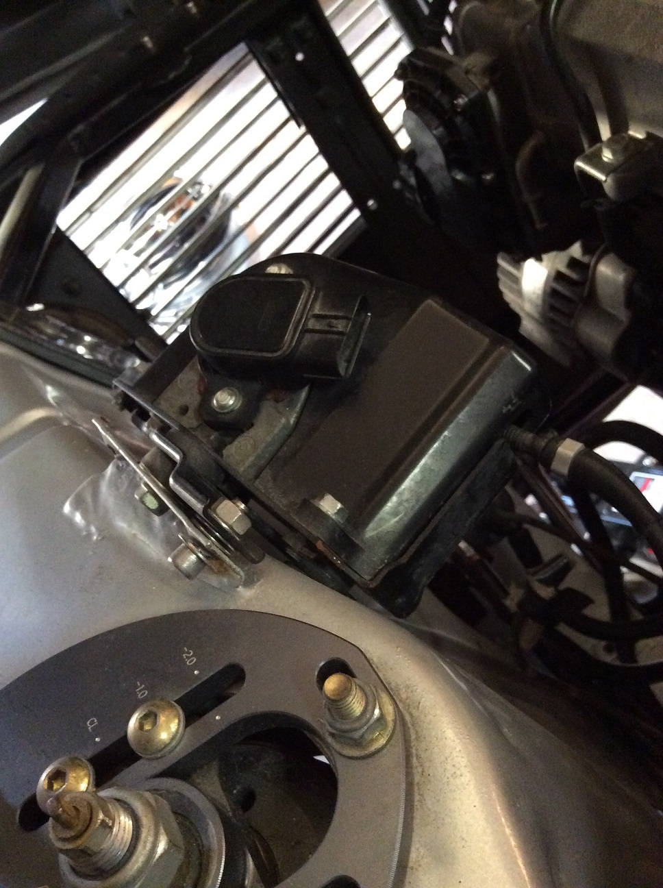

I am trying to finish up my F22c swap in my '72 bmw 2002. Can anyone help me and tell me what is I need to do to get the Accelerator Pedal Position (APP) sensor hooked up?
I have the engine harness and the two harness' that go mounted on the inside of the car. I was told I need the left headligh wiring harness. Can someone verify this? Do I also need the right headlight headlight harness as well?
Any help is GREATLY appreciated. Thank you.

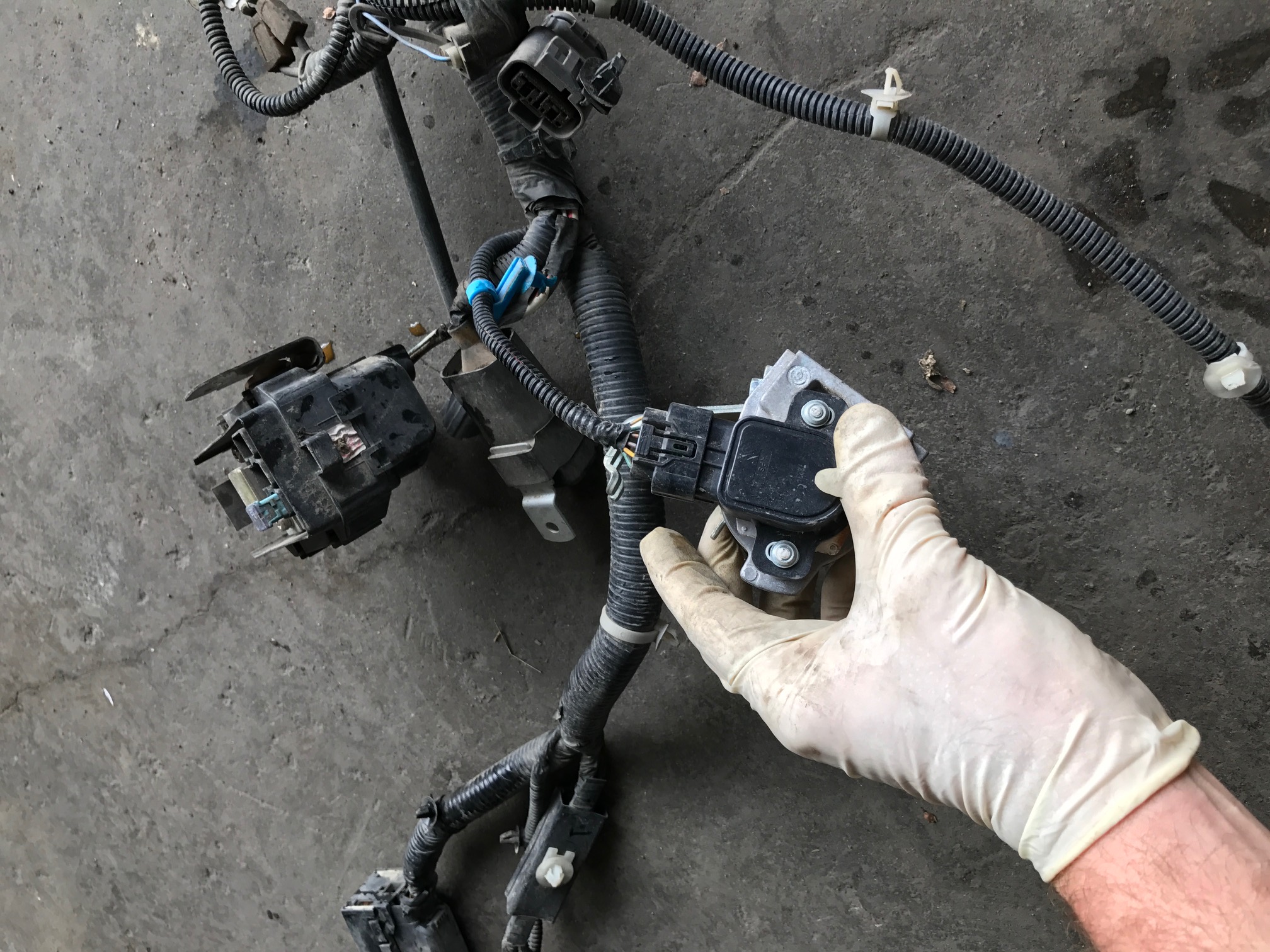

Default found it!
I was missing the driver side headlight harness. The engine supplier was able to locate it. The engine/tranny is a 2007. Thanks Spartarus !
