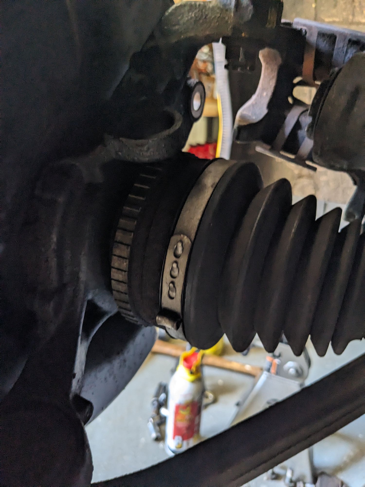

Good morning all,
I have an 01 which I primarily use for track days, autocross, and spirited driving and am in the process of doing a rear wheel bearing/hub replacement. The car spent half of its life up north, but garaged, so it has a little bit of rust on the suspension bits plus it has 130k miles so it's sometimes a pain to work on. I got everything apart and am at the point to separate the axle from the hubs but they just will not separate! I've been PB blasting it for weeks now, heating with a torch, whacking with a mallet, and even resorted to a hub puller but it ended up just digging into the axle. I'm at a loss as to what else I can do besides removing the axles from the car to get more room to whack harder from the back or just replace everything with new hardware.
Does anyone have any other suggestions as to what I can try to get the axle separated from the hub?
Thanks in advance.

Got a photo of its current state? I just replaced my axles recently and it didn't take much force from a mallet to knock them loose for me.
Not sure how it'll help but I'll give it a shot. Let me know if you spot anything!

Can't tell from the photos but I'm going to assume you popped the lower balljoint, otherwise I have nothing else to add. I'll go back to "doing California things."
