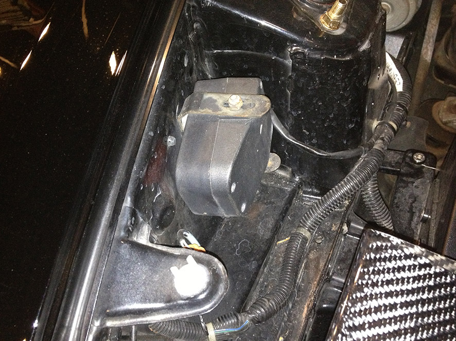

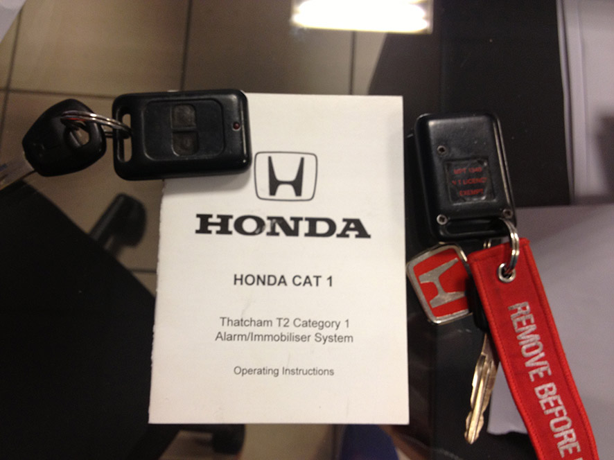

I've put below two pictures of the remote handset and of the siren under the hood, if it make you think about something... thank you guys for your help!
