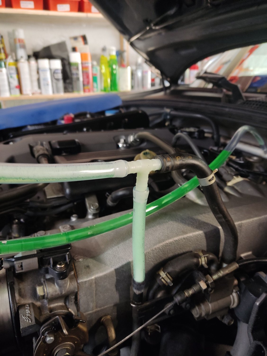

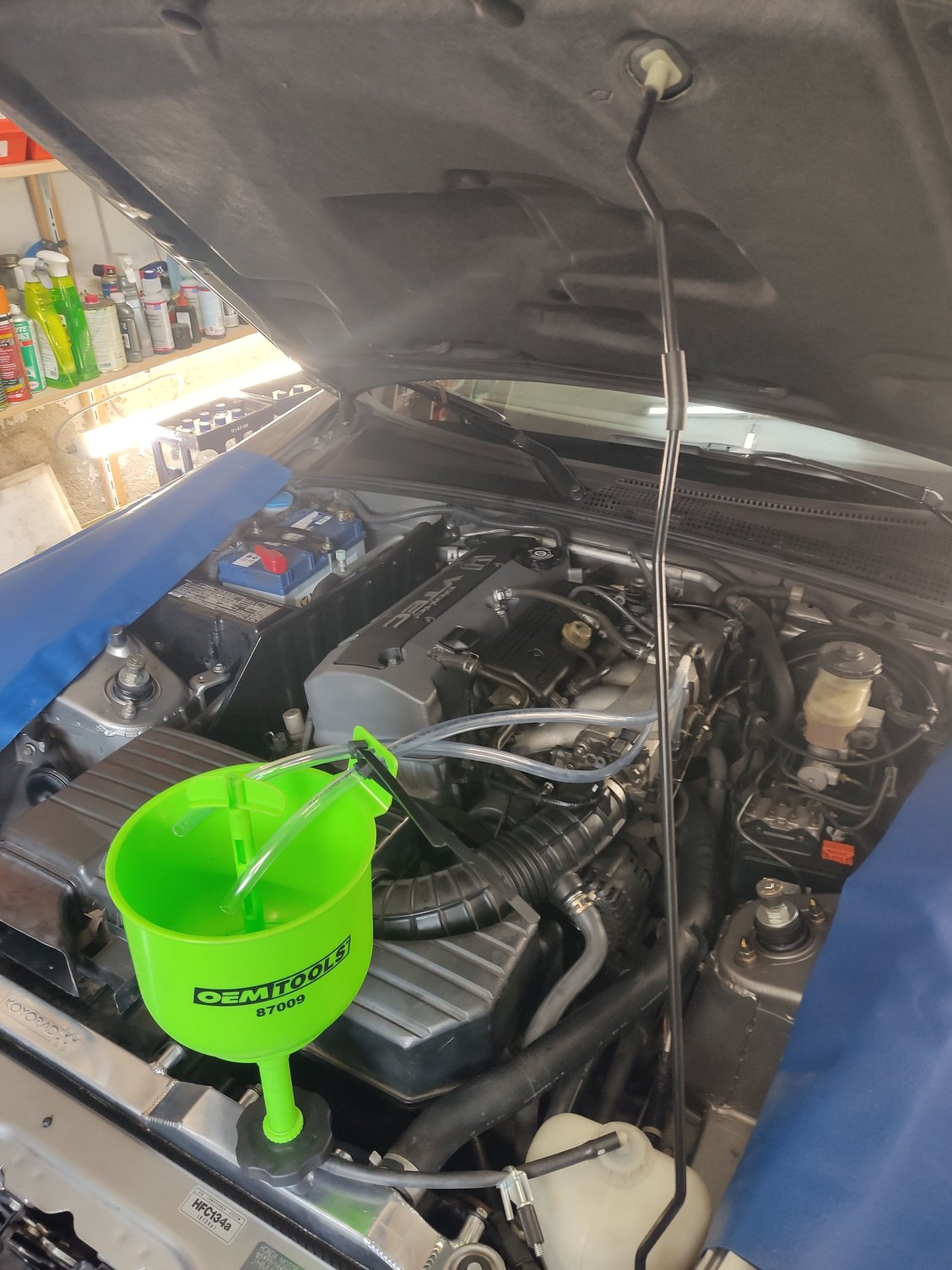

You need a Bleed Bucket, preferred with a extension. Some 8 mm inner diameter clear hose and a T-connector. Bleeding points are the Hose at the idle control valve and at the heater tube at the firewall. Leave the bleeder nipple at the Cylinder head closed. Set it up like this:
Fill it up with coolant of you preferred choice and mixture, start the car, dial the heat to "Max", leave the heater fan "off" because this will only act as coooler. We want the car to get hot soon.
No the magic happens, all air bubbles come out and you just sit there and watch them...

You clearly see that the Coolant is on the same level in the tubes and the bucket and there are no more air bubbles. Now you can open up the bleeder valve at the cylinder head briefly to be 100% sure that even the last tiny amount of air wich maybe is trapped there can escape. Let everything cool down. Remove the Bucket, the tube form the Heater line at the firewall, and re-connect the hose at the idle controll valve. Use a "Hose pincher" at the hose when you re-connect it to avoid loss of coolant and air coming back into the system. It will be only a tiny amount, but nevertheless....
A word of warning: This can be a bit messy. As long as there is Coolant in the Bucket, it is the highest point and coolant will flow out if you pull the vinly tubes until the fluid level in the system has equalized. Work along and pinch the hoses. Suck coolant from the Bucket with a syringe to lower the level gradually. You will find a way. And yes, i have this bright ideas after i have done a mess...

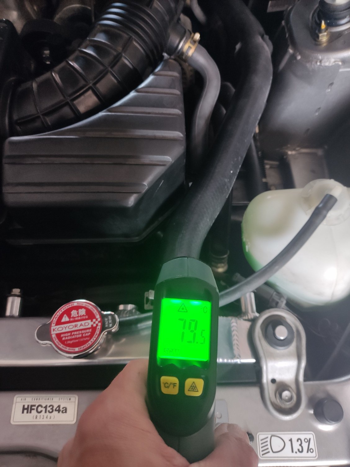

Lets see. I had the car idling in the garage with the Radiator cap on. Testing for leaks with the system pressurized. I take the meassurments after the cooler fan was running for the second time.
Ambient temp, fairly cold, we had snow last night. 8° C / 46°F
Upper Hose: 79.5 °C / 175°F
Upper hose to the heater, at the clutch master: 78.3°C / 173 °F

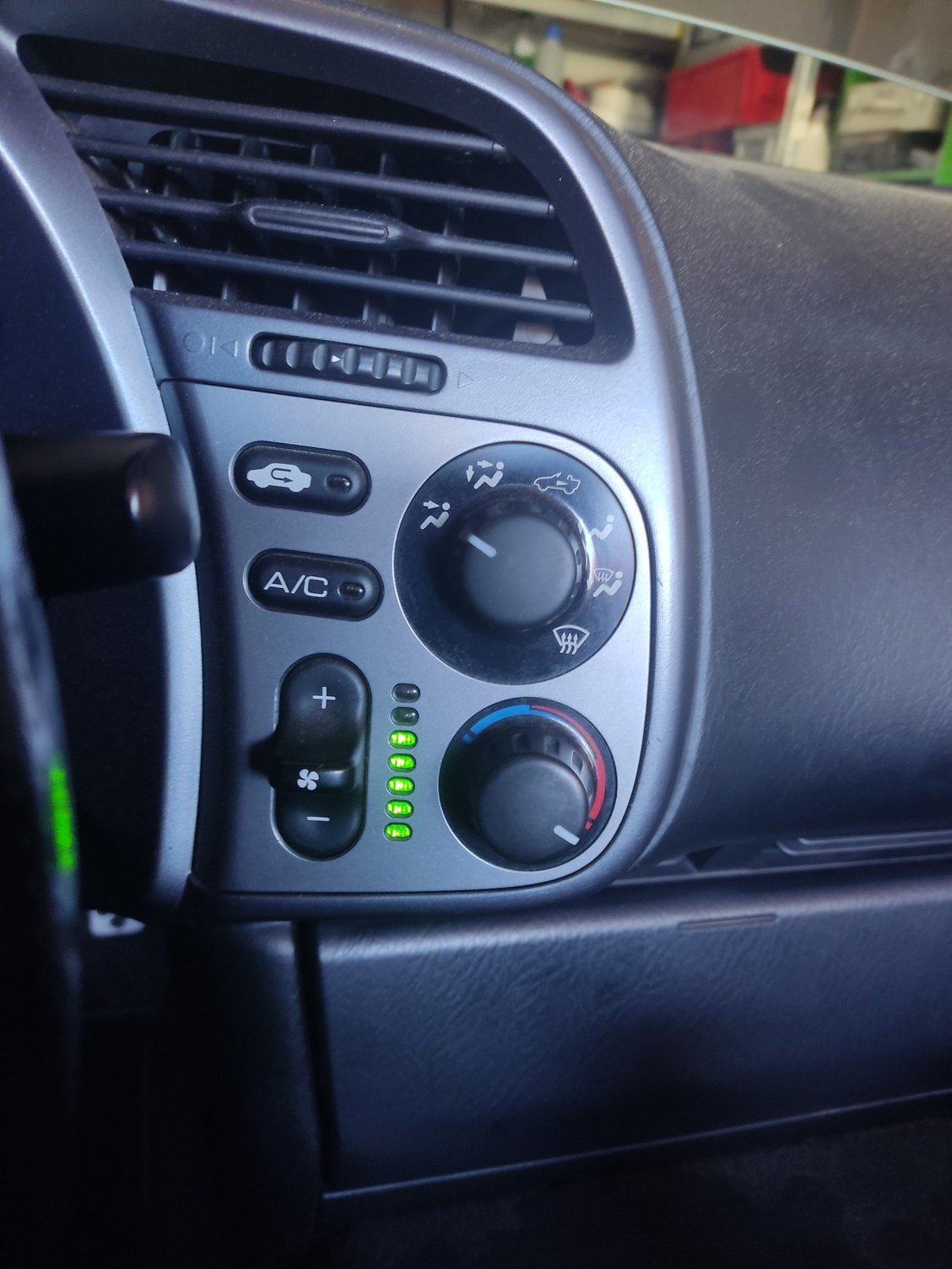

Settings of the heating:
Upper air vent left of the steering wheel 72,6 °C / 163 °F
Good enough? I think so.
