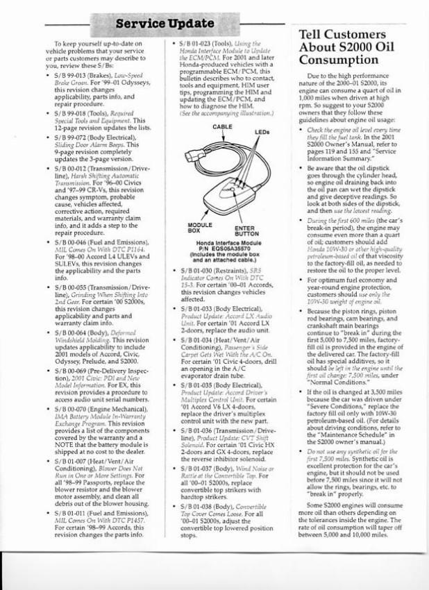

Old Mar 21, 2003 | 03:58 PM
StwoK's Avatar
Posts: 1,621
From: Findlay
Originally posted by dleap
HONDA should let buyers know that this car guzzles oil if you drive it hard. Why else would you buy this car, but to drive it hard?
You're right at the mileage where so many other people have also posted about their high oil consumption rate. This is a performance car and they do require more attention then a normal car.
In the fall of 2001 Honda sent this Service Update to its dealerships. Please note the right hand column.
