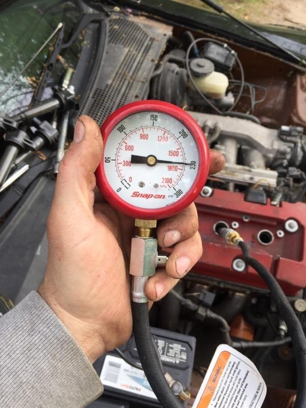

I'm looking at a used s2000 AP1 engine from a local seller and they sent me compression readings of 238,250,251,240. Does this seem normal for an engine with 111K miles? The car does run and drive in its current state but I want to make sure the car is healthy and can handle a turbo.

looks healthy to me.
their gauge prob not calibrated properly though, those are insanely high numbers, if its psi.
you may also want to do a coolant pressure test as well.

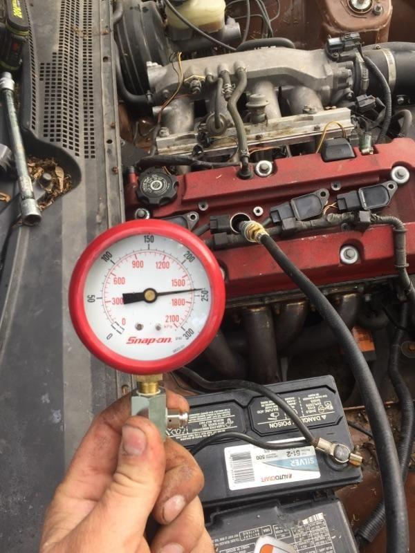

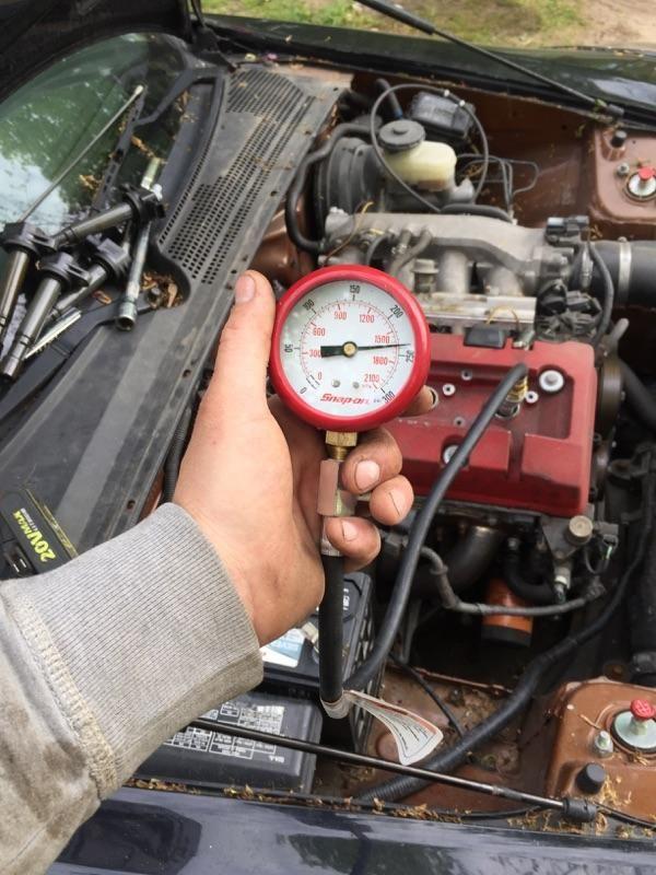

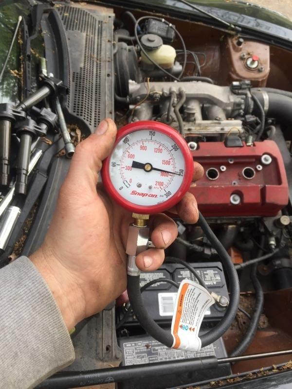

Default Pics
Some pictures provided to me from seller.

why is the engine bay color poo poo brown? and what kind of shocks are those? filter es no bueno.
compression looks fine.

Fram oil filter
backwards battery
plugged off evap system
oil cap lost at some point/non oem
hacked wiring
car sits out doors in the woods
throttle cable hanging out un mounted
all head shields missing
likely non original engine due to engine bay paint color
brake booster hose missing mount
air pump block off plate
cowl weatherstrip missing
relocation of both fuse blocks, likely due to turbo
While none of these things may mean anything about the engine, there is a great deal of negligence and hackery surrounding it.

The engine could be good, but should be inspected by the buyer or third party.
Even if the cylinder walls are trashed, compression numbers can still come up perfect.
