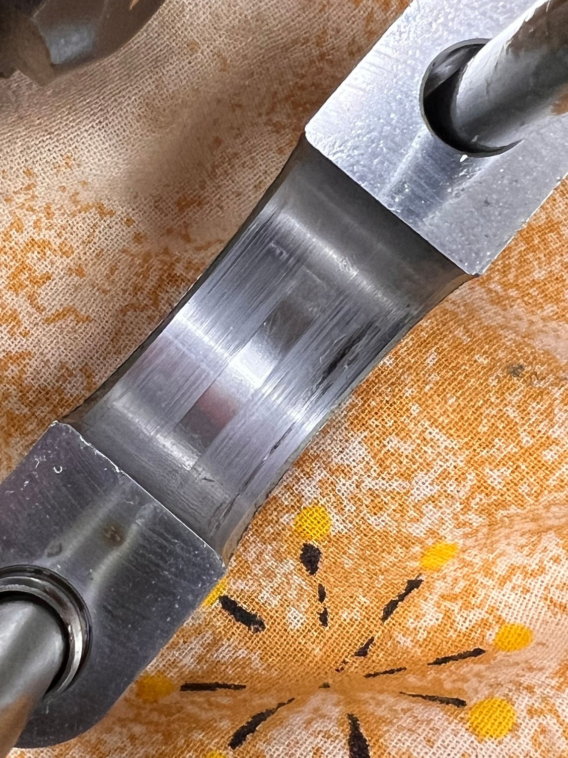

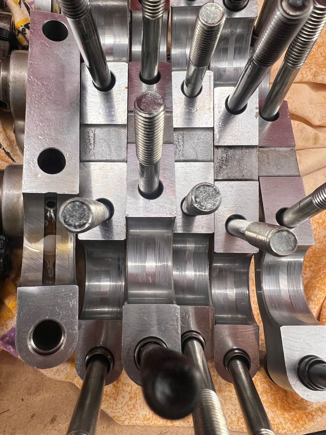

is this normal wear and tear? the lower storage is beautiful.. only the capa are scratched
F20c2 2002 140 000km

They get oiled from the bottom, so naturally they'll look better. The cam cap you showed doesn't look good though.

They look okay but it’s hard to tell from photos. I didn’t take photos of mine (AP2 at 13k miles). But the wear pattern is similar and I was able to feel them with my finger nail. Polished by machine shop and all is still within specifications.

Looks not great, but O.K. for 140.000 KM. You could install them again or maybe let a shop polish them.
These camshaft bearings are located at the most distant point away from the oil pump in the engine. Therefore, these are the last bearings wich get properly oiled when you start the engine. To make things worse. aluminium is a lousy material for a bearing. To avoid this, allways let the engine idle a little bit before you drive away. Especially when the car was sitting for days.This is even mentioned in the owner manual !
And, so much for the "Oil film left that protetcs the engine at cold starts".
