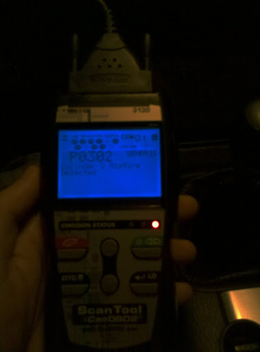

bought Equus 3130 - once it's here I would know if this is the same cel or not..
I'm not sure but want to do valve adjustment and see if ignition is okay. What's the service interval for this engine for valve adjustment?

misfire in 2nd and 4th; I swapped coils (2->1 and 4->3); cleaned CEL and drove to fix my windshield crack <3miles;
it came up again. can't be all four coils went bad.
can't be ignition timing causing misfire in only 2/4..
thoughts?
