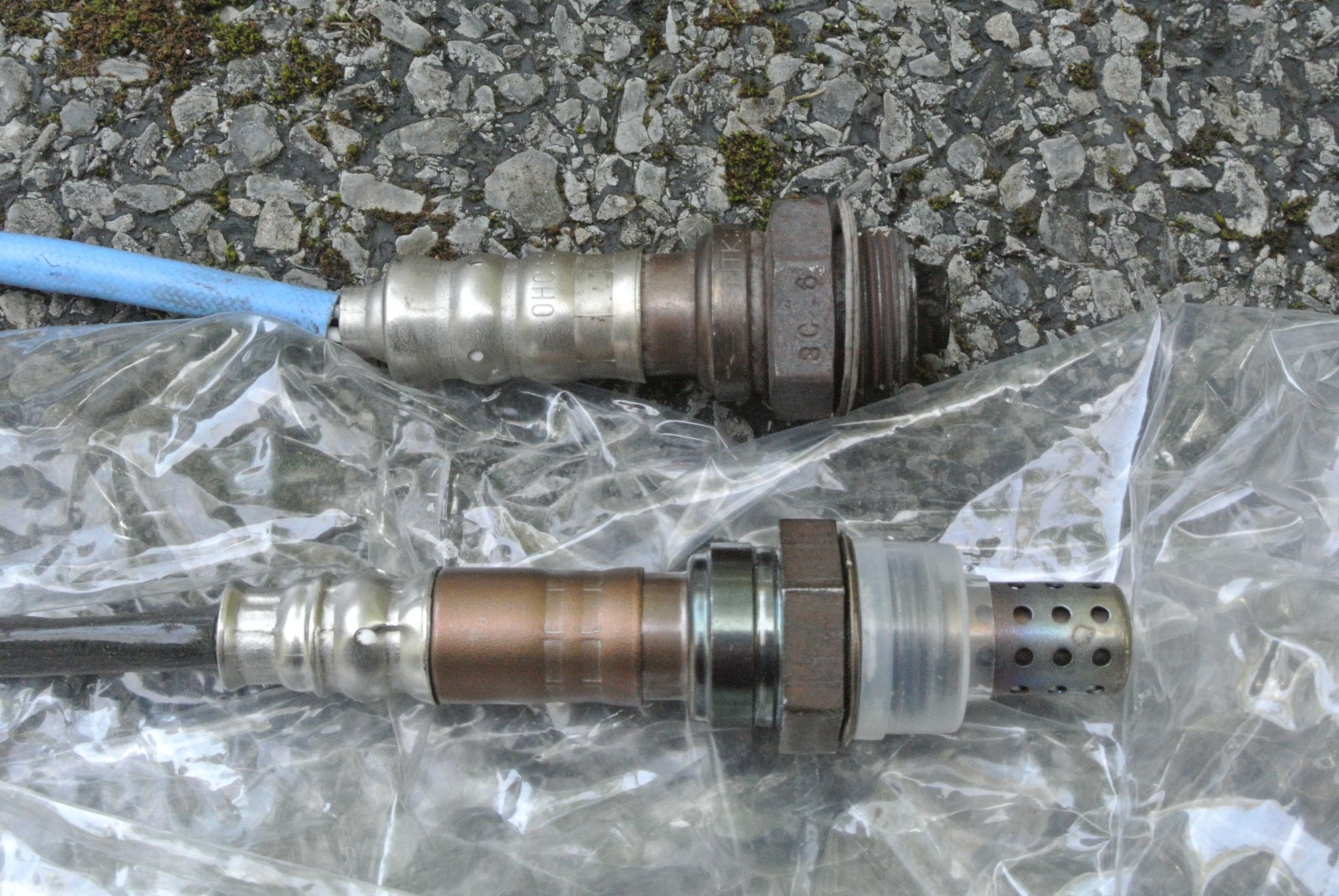

The o2 sensors are delicate. If they are knocked around too much, it breaks the heater circuit in the o2.
Your o2 heater inside the sensor is broken, but making momentary connections to keep the light off.
A new sensor will cure it.
Because the rear sensor is not critical, and only measures catalyst activity, I use a Denso auto parts store o2.

Thanks for the input guys. My stock cat "brick" was vibrating/rattling mostly at idle, for a couple of years? I thought it was a heat shield at first but it got worse and my buddy and I put it up on our lift and he confirmed it was the brick while I ran the car through the rev range. I had already purchased the BERK to replace my stock cat. Then later in the season my CEL came on with several O2 codes. When I took it out it appeared the brick had broke the O2 sensor tip off? I did not twist the wires because I took the whole cat out first. I also reused both of the OEM wire clips on the new sensor wiring, which was almost twice as long as stock! Chuck, CEL did not come on right away after the install, took a bit over 2 weeks the first time and 3 weeks the second time. No smog in NY, just state inspection, but as you stated the CEL cannot be on if you want to pass. I'll go with Billman's diagnosis and replace the O2 sensor with a Denso. My only other question now is: Do I have to replace the exhaust gaskets on each end of the cat when I remove it to swap out the O2? I would think the "donut" one up front is re-usable but what about the rear one that came with the BERK?
