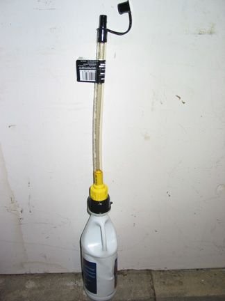

I used the Xviper tutorial to change my tranny fluid to GM Synchromesh tonight. Here's the bottle:
I also found this filler valve that fits on a gear oil jug and some transmission fluid bottles. I had just a few ounces in the gear oil jug and cleaned it out with dawn and water. I then dried out the bottle and poured the synchromesh in that. It worked great:

That's the filler valve I used too.

i too used the same filler tube.. the only difference was that i used Penzoil Synchromesh stuff because the damn chevy parts place closes right at 5:00 (good customer service huh).
