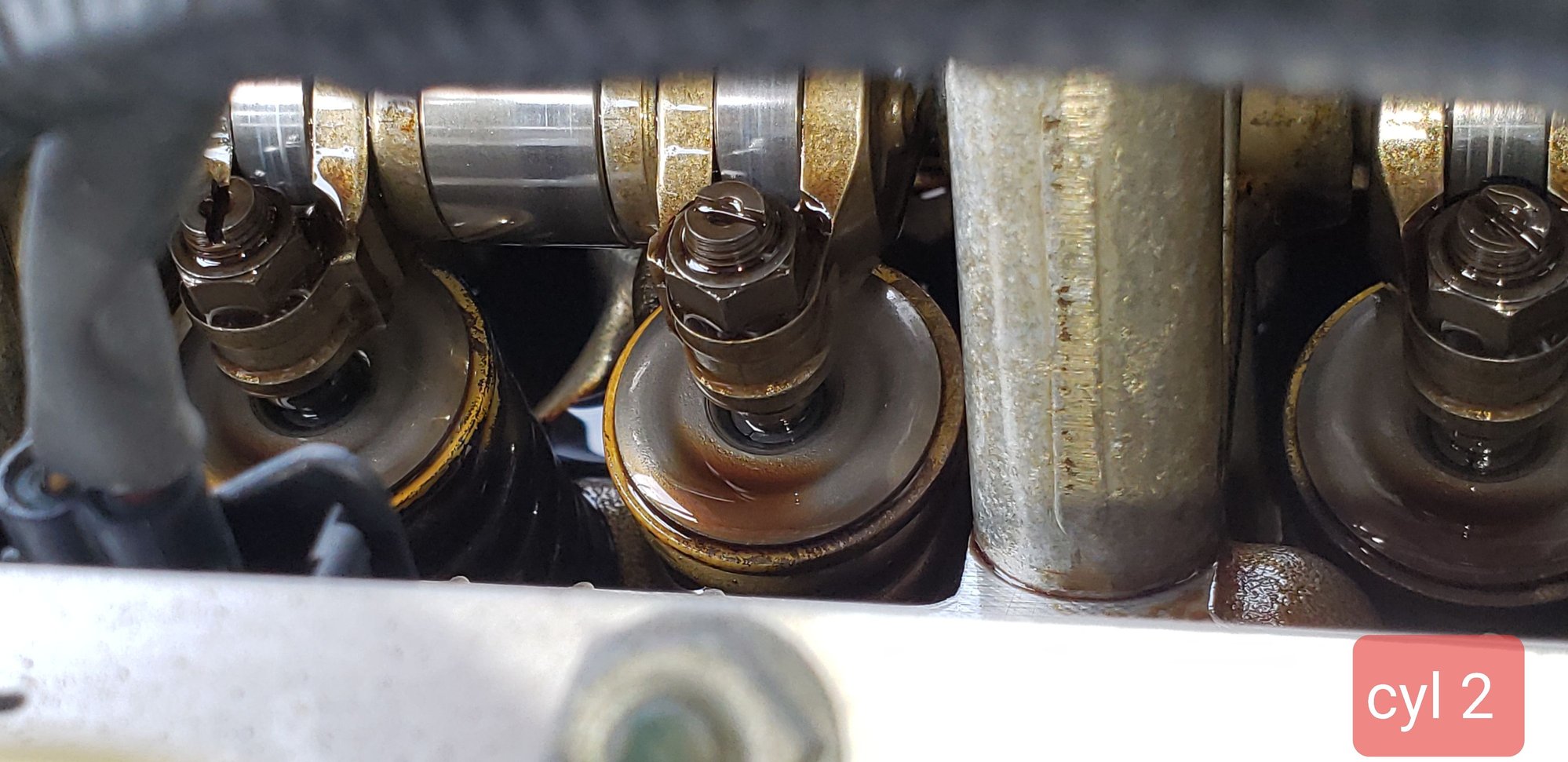

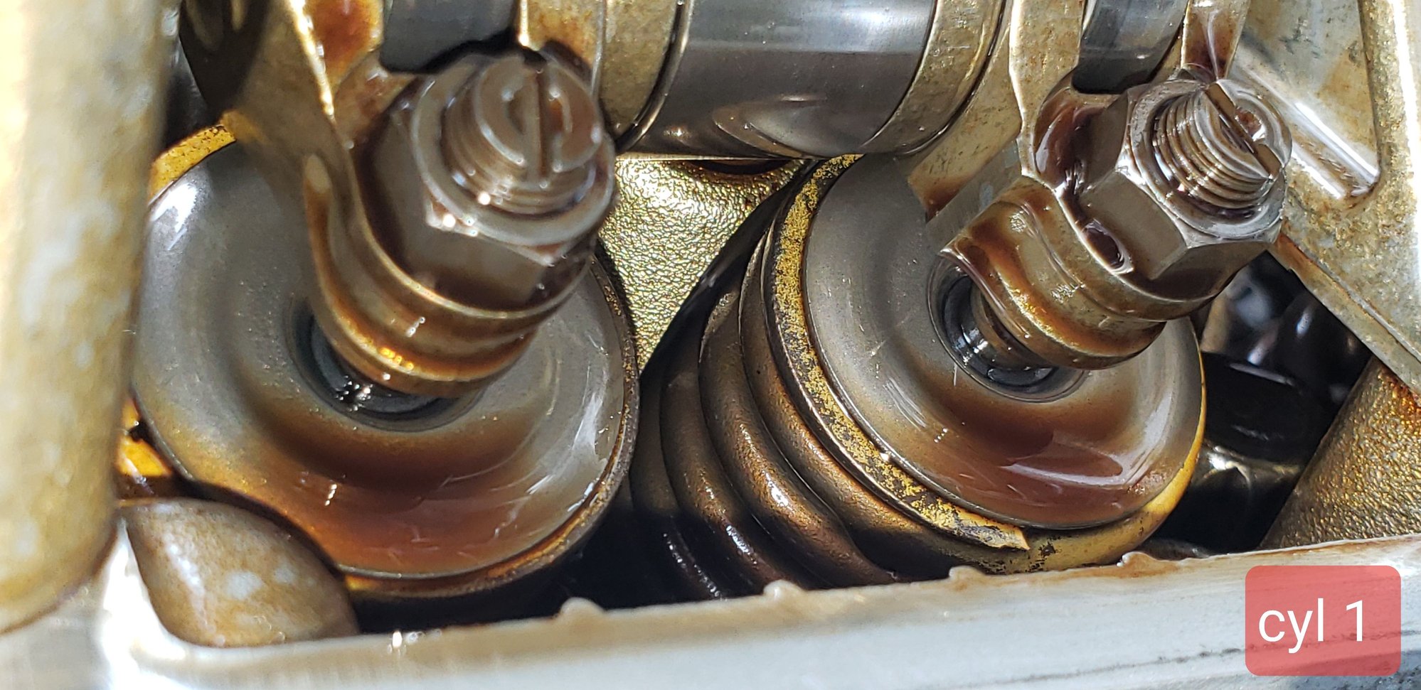

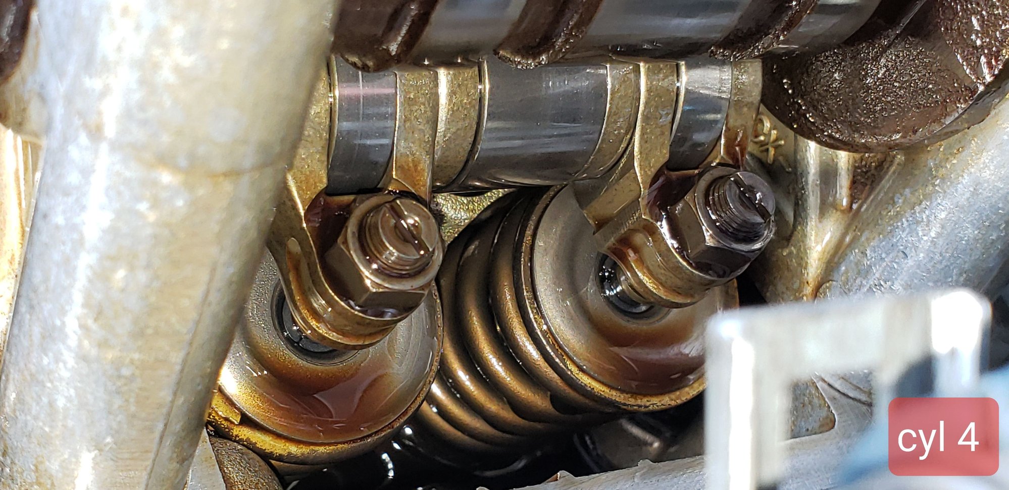

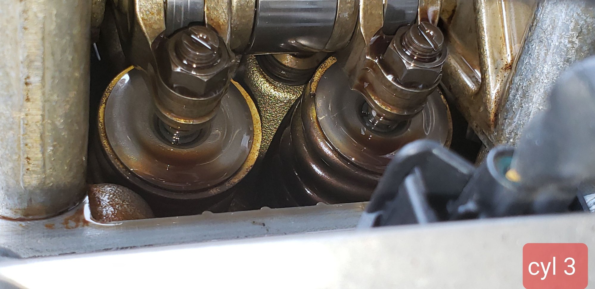

Thoughts on mine? This is an AP1 F20C with AP2 retainers and keepers on the intake side.
thank you!!!

to me, cylinder 2 on the left looks...um...questionable...but the shadowing isn't ideal. Is this an AP2 or an AP1 with already changed out retainers? My experience is AP2 retainers have a deeper inner bevel vs. AP1. Maybe Billman will weigh in for you.
darcu

My apologies with the less-than-optimal pictures, it was tough with the lighting (i was outside too, but this hood makes it impossible to take decently lit pictures)
1) This is an AP1 F20C motor with AP2 retainers/keepers on the intake side (thanks for asking, I've updated my original post as well)
2) If you believe me, they all looked identical to me in person
