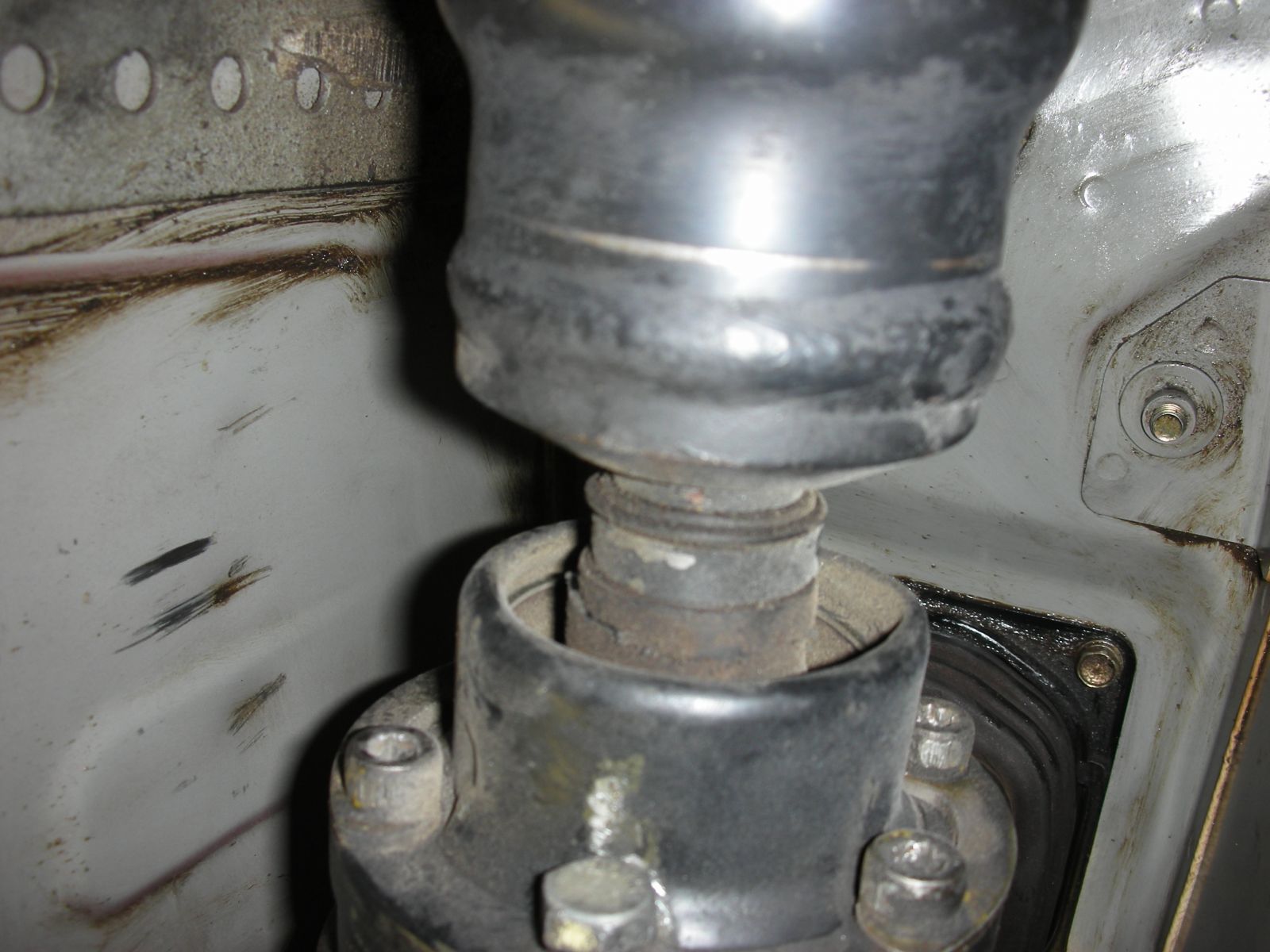

I checked again, could this cause it?
The little rubber piece is broken on it. Could that cause this sound?
