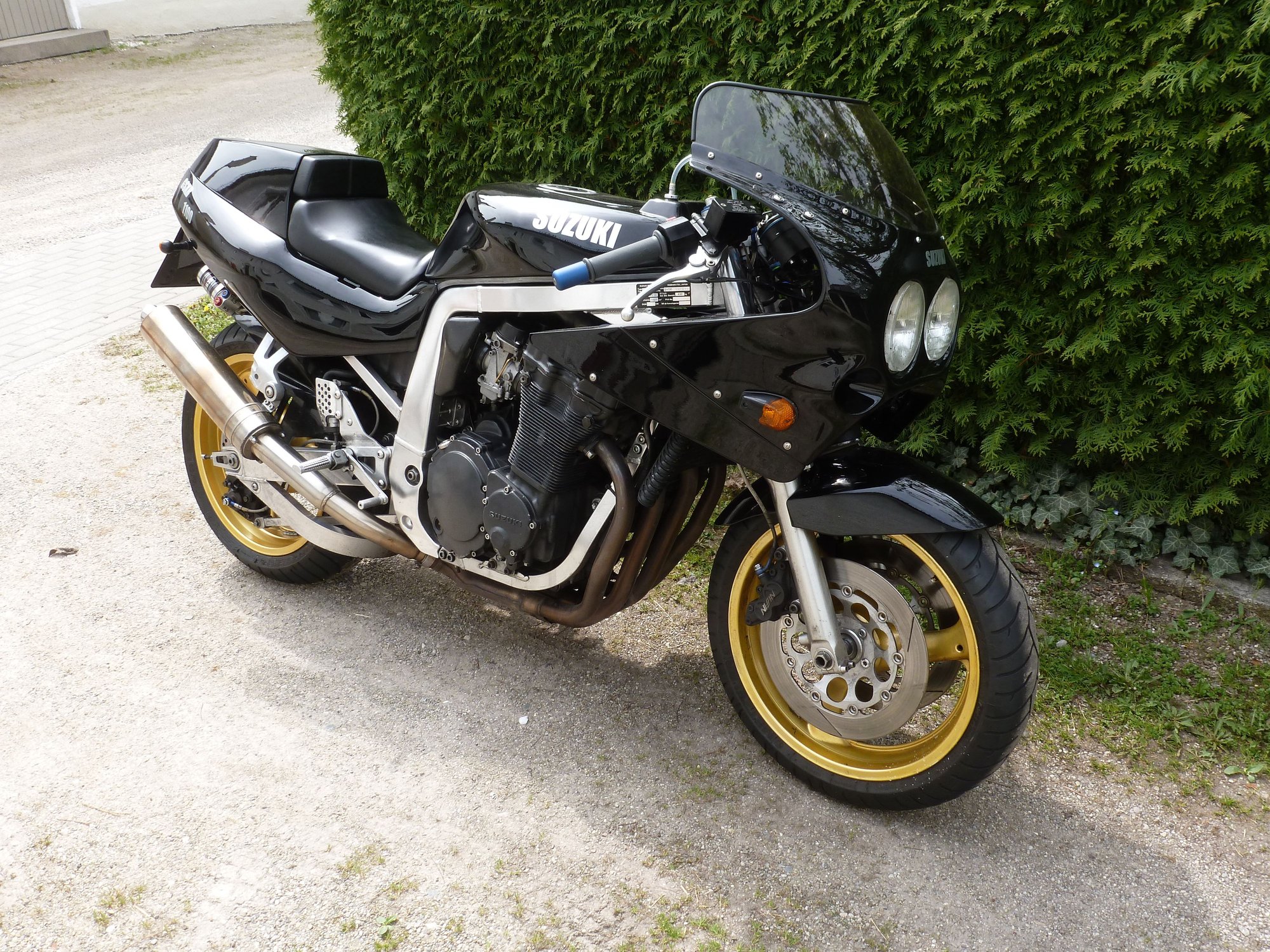

People allways asked me why my motorcycle "has such a shabby, rusty exhaust" back then when in fact it is stainless steel, just coloured by heat.
At one point i was feed up with explaining and simply replied "Yes, next winter it will buy a new exhaust system..."
Thats why i asked here for pictures.
