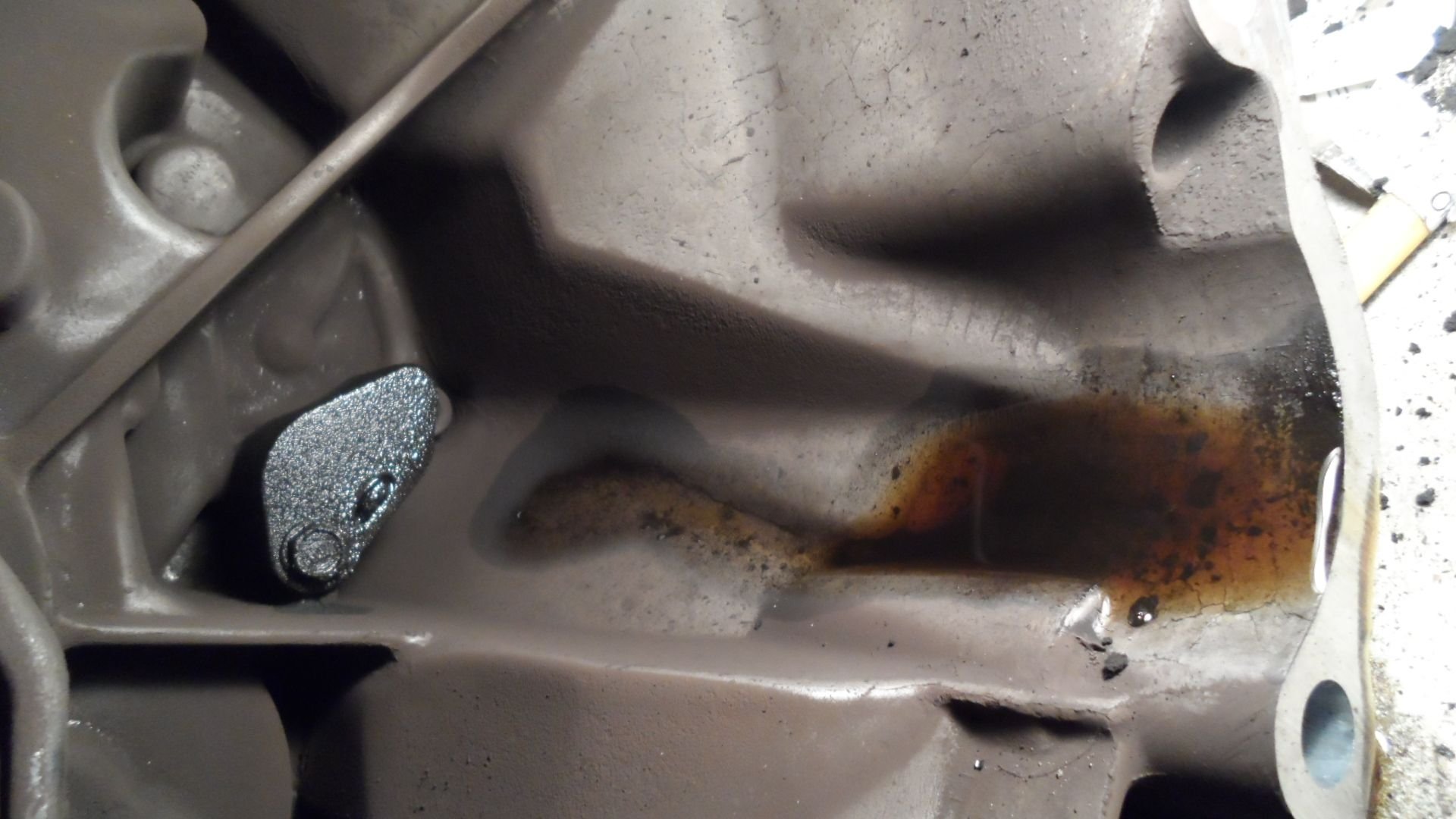

Hi guys im changing my flywheel to a competition clutch flywheel and new clutch
I have the train out and I have a question about the little cover inside the transmission bellhousing.
It was dry as a bone when I removed the transmission at first but then since I didn't have the car high enough while installing the flywheel I left the transmission on its side under the car
a bit of transmission fluid has leaked from this cover (which is also quite dirty looking)
what do you guys think ? is this leaking because I have the transmission on its side?
Should I stop and wait a week for the dealer to get me this gasket?
Can or should I use gasket maker?

That's the trans vent. Your leak is normal due to the trans being tilted.
All good.
