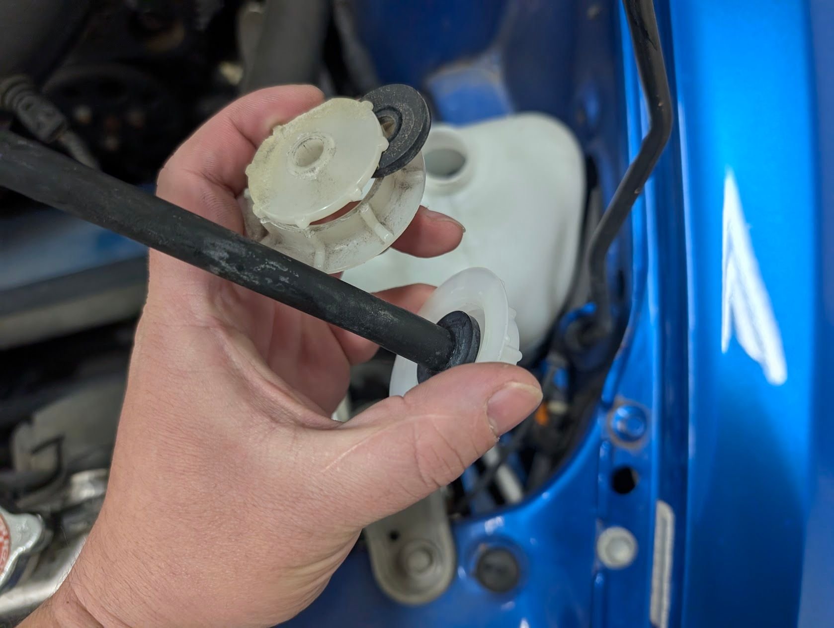

I've been going over the car, checking things I should have checked a while ago, and noticed my coolant overflow reservoir was bone dry. The reservoir cap was cracked up pretty bad. I've already replaced the cap, washer, and elbow for the reservoir. The reservoir now has the correct level of Honda Type 2 Fluid in it.
