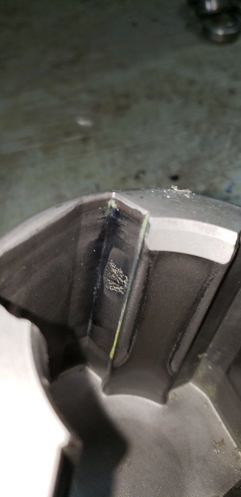

The problem is that the surface of the cups is hardend. The metall added by welding is soft.
It is possible to adding material by welding, regrinding the material and re-harden it, but is a very costly and uncommon work. Not many shops ar capable to do this. To my limitied knowledge, it is so expensive, it is only done for very expensive oldtimer engine Parts.
For us, it is the best way to buy new OEM Honda parts and try to prolong the live of thes cups with the best grease you can get.

The bearings are harder than the cup. So they erode the cup. Its erosion wear.
Of course, greater impact force and pressure on the cup/bearing interface while the travel is happening accelerates the wear.
Redline grease is supposed to help protect from this, with its EP qualities and moly additive

They do travel more with more angle. But I have seen that wear on CV joints in the past. that is a nice smooth wear pattern typically but just creates a low spot. That is not pitting. Pitting is material being broken away. Aka, you can see the impact area and sharp edges where material actually breaks away, not wears away.
There are two ways that a CV starts causing vibration.
If it has been in the same angle range for a long time (and thus there is a wear pattern there) and you change the ride height, the bearing now is rolling over the edge of that wear area now and is causing a vibration.
In the other case, if the cup is suddenly damaged and material is broken/chipped away, it causes vibration.
The former is what I would simply call wear. The latter is what I would call pitting. Both times mine have pitted it was after multiple very hard launches. And there is a very obvious section of damage where material is broken away inside the cup. And I mean, car was perfect, took it to a practice event with a straight, hard start and launched it very hard multiple times, then the vibration started immediately. This was after tens of thousands of miles being run at the same ride height with no previous issue. So hard to say that is not from the abuse of hard launches. Now did the changed angle of the shaft increase the odds of it happening? Maybe, maybe not. But I am willing to bet that on a completely stock car if you go out and launch at 6000 rpm with wide sticky tires enough, you are likely to damage a CV joint the same exact way eventually

Its not from launching. I'm confident its from erosion.
Think about it thusly....If you rub two very smooth (high surface finish) peices together for long enough at an extremely high speed and pressure, one of them will break away in small chunks, right?
It will almost never be smooth wear in that case. You're thinking of abrasion wear from one roughened surface (like sanding something with abrasive).
Cast parts sometimes also have pits or soft grains below the surface hardened portion.
Rotors can and do also pit like that sometimes.

Must be a Honda thing, as that is very strange wear from just bearing travel. Anytime I have seen anything like that before it was from impact of some kind, and odd that my only occurrences have been immediately after beating the shit out of it for 30 or so hard launches. I guess it is a combination of damage and was just exhibited by the hard launching back to back.
I still dont think the redline grease does any better, at least it has not for me. Actually happened a LOT faster to the recent one that was swapped side to side and had redline grease in it. Like I said above, the grease had mostly moved into areas where it was pushed back from movement and just stayed there. Will see how long it takes to happen again now since I used the rest of the redline grease I already had. If that one pits as fast as this last one I am trying something else. Whatever was in there (Which was most likely OEM since the cups had never been swapped) did fine its entire life, including at least 6 or so years of being lowered. Swapped cups, used redline grease and 10,000 miles later pitted again.
Hard part now is that all my parts, including spares have tons of miles on them so it is hard to definitively say what works better/longer as most are probably experiencing now. Best test would be two brand new axles, one with OEM grease and one with redline. But no one is volunteering to spend the money on new ones to test that, which is why we have these conversations!

Honda has chosen the grease based on a VERY controlled experiment. But unfortunately, lots of people are seeing pitting at various mileages. Usually (+/-) in the 100K mile range.
My wife's car (2011 TSX sportwagon) started shaking at like 70K miles. As of 90K miles, it has low mileage OEM axles with redline in them. We've only done 10K or so since the swap. So far so good, I think.
My 6MT TSX started shaking around 135K miles. At some point, I did the same type of OEM rebuild situation and it held up fine til I sold it.
My 00 AP1 started shaking at like 50K miles. I used axle spacers but got more vibrations at 65K miles. I flipped the cups, but got vibration on downshifts. So I finally just replaced the axles with low mile JDM ones with OG grease around 70K miles. No issues thus far at 95K miles. Car was lowered, tracked, launched, etc. I'm sure launching does not help any of this. This car now has a fairly easy life.
My wife's 04 AP2 was shake free with original parts for 92K miles. She drives like an adult, though....
My track 07 AP2 has 170K miles. No clue if axles are OG. They just started shaking now.
There are probably manufacturing changes with the cups or the grease had been reformulated (totL speculation). There are massive inconsistencies.
