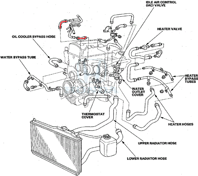

I recently replaced the radiator to a Koyo in my 2005 with 100K miles and noticed that whenever I take it for a drive, it would strictly smell coolant near the bleeder screw. I tried cleaning the area near the bleeder screw and it would smell in that vicinity after a drive. I can't visually see nor feel any leak. Any idea what might be causing the smell near that area outside of the bleeder screw itself? Anything around or under that might be causing the smell?
I initially had some seepage on the ends of the hoses highlighted in red, but changed and not leaking anymore.
I noticed after a 30-45 minute highway drive, I would lose approximately 1/4 inch on the overflow tank (when it was @ max).
Any help to point me in some direction on what can be possibly causing this would be greatly appreciated.
