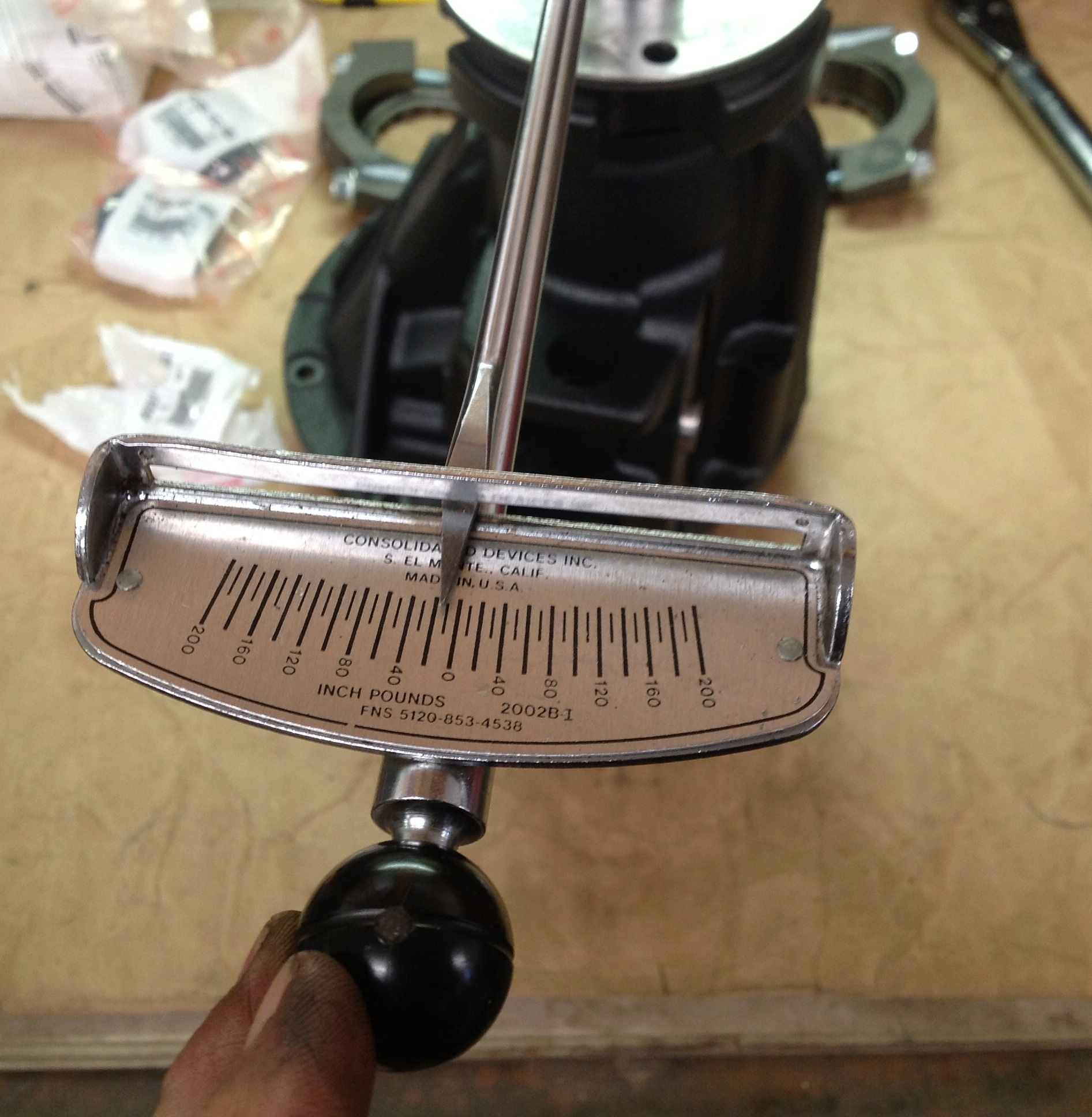

How tight is it, do you have a inch pound torque wrench to check the bearing load on the input flange?
Old Jan 2, 2014 | 09:52 AM
S2KPUDDYDAD's Avatar
Posts: 8,463
Likes: 25
This is how to check the load, with the ring gear in place it should be around 12 to 20 inch pounds
I posted a pic to try to show you how to check the load
Attached Thumbnails Diff/LSD problem?-image.jpg
