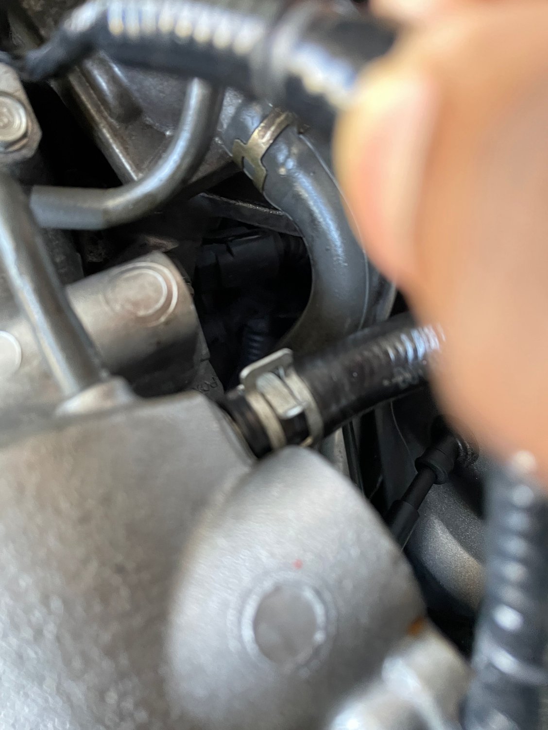

For anyone like myself trying to do this, the attached photograph is lovely. However, if your engine is in the car like mine is it's firewall driver side. Underneath the gray rubber you will see the adapter, you need a 19mm or 3/4 wrench to get it off. Will also need to disconnect two hoses that'll be in the way and once you remove the adapter be prepared to catch the coolant that will be coming out. (It will be alot)
