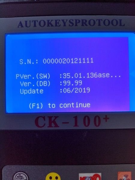

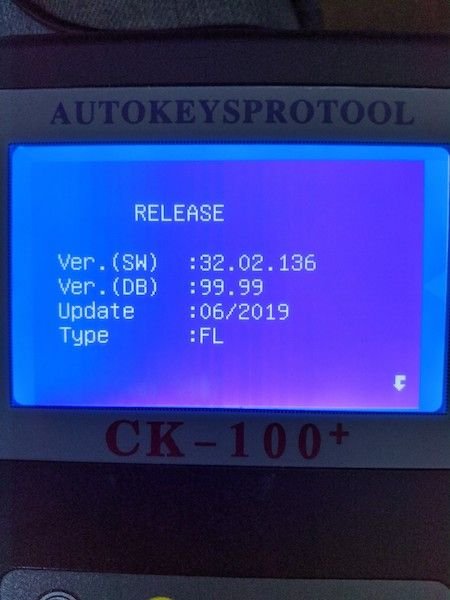

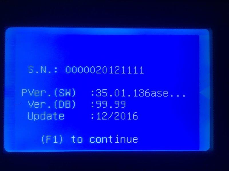

The firmware is locked and is not updatable unfortunately. If you look at my pictures both the software version and database version are exactly the same as the OPs. The only difference seems to be the update date (2017 vs 2016). It is not clear what this date even means really.
There are different versions of the CK-100 which do have software versions like 46.02 though.

I have a German S2k MY2001 and tried this procedure without luck. The CK-100's 'Honda' category does not have the S2k. The 'Honda USA' category does but I was not able to connect to the ECU. I've posted pictures of my CK-100 version. The only difference I see is the later 'update date'.

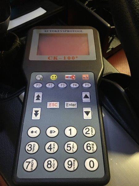

CK-100 programmer. Attaches to your OBD-2 port and powers via standard 110V outlet.

This is the SW version on my unit. v99.99 is the most current version as of Feb 2017.

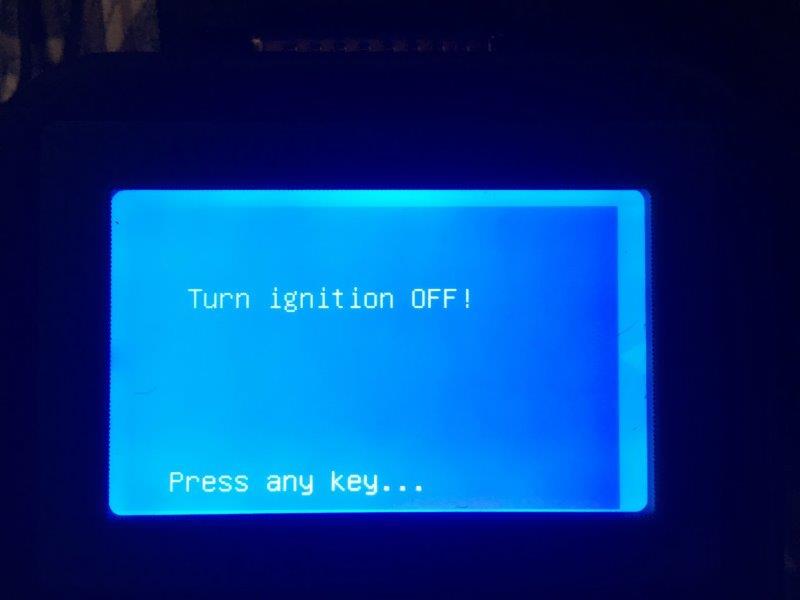

From here on just follow the steps as you see on screen. I might have missed a couple of off/on steps here (following steps and photographing is too difficult for me I suppose, lol)
