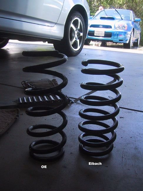

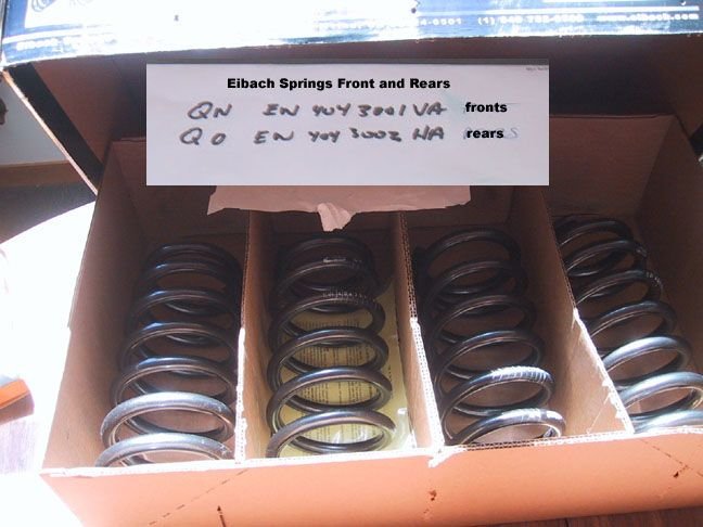

Eibachs (note: the numbers for the front and rears)

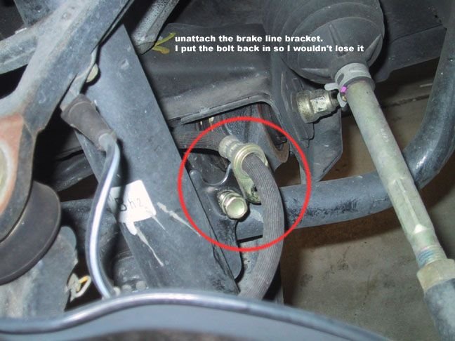

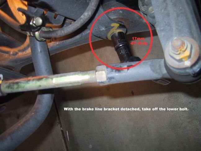

Jack up the front end and remove the wheels. Unattach the brake line bracket
Now unscrew the bolt tot he lower bracket of the shock. (note: the torque specs are listed for when you put on the new shock)

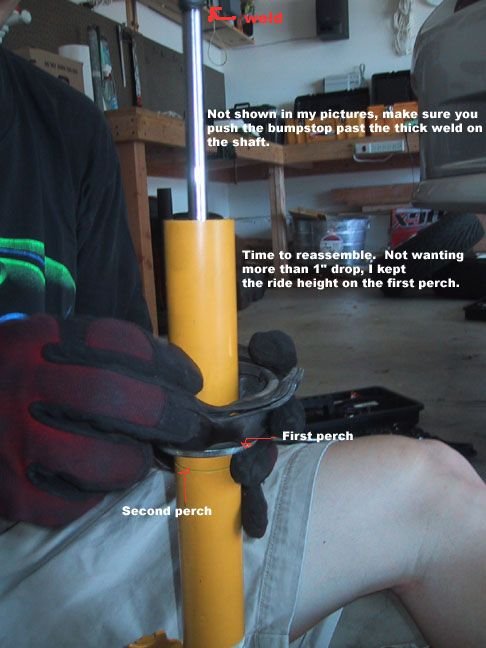

I did NOT cut the bumpstops

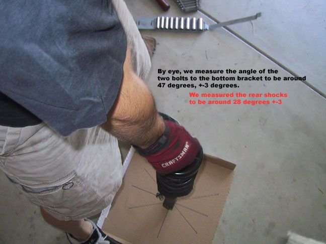

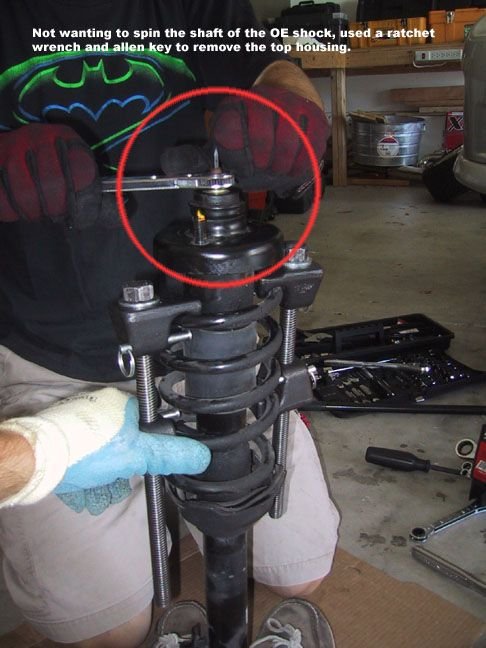

dremmeling out 8 rose bushings and 4 dust covers, was one of the most time consuming part of this projects. If we only had a proper drill bit.
Reassemble the shock and put it back the way you took the old one out. don't forget to torque everything down

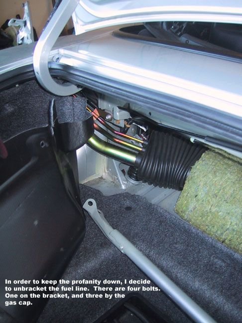

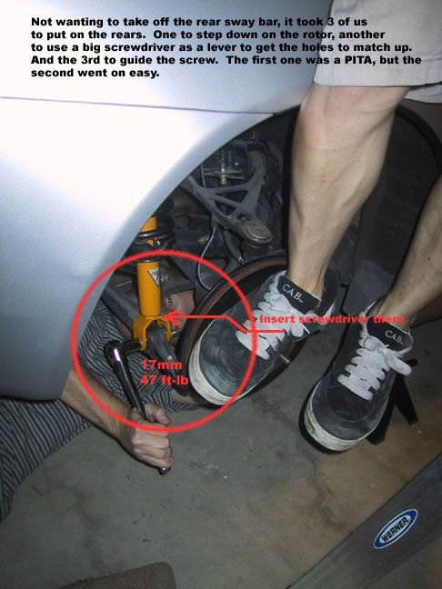

Time for the rears. Before you jack up the rear, remove the spare and pull back the carpet to expose the top shocks.

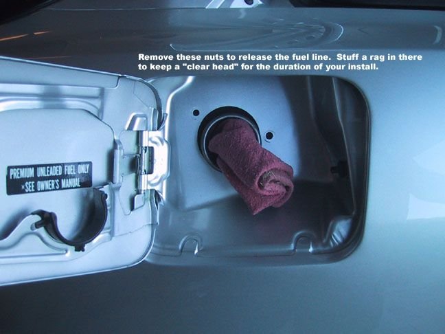

I highly reccommend detaching the fuel line. It only take a few minutes and will save you hours.

Save gas, it's expensive
Pop off the rears
Voila! My car is now 1" lower and I love it. It rides nice. I'm still getting use to how far I can push it. I have the Koni set at about halfway between full-firm and full-soft.

Nicely done indeed! How did you remove the fuel line?
I didn't remove the fuel line. I just unbracketed it and push it aside. It gives you the extra inch or so to reach the nuts on top of the shock.

that is ingenious!! i wish i woulda known before doing mine... my install had A LOT of profanity... heheh

looks great BUT when we did Cub's car we did not remove the gas tank feeder line
