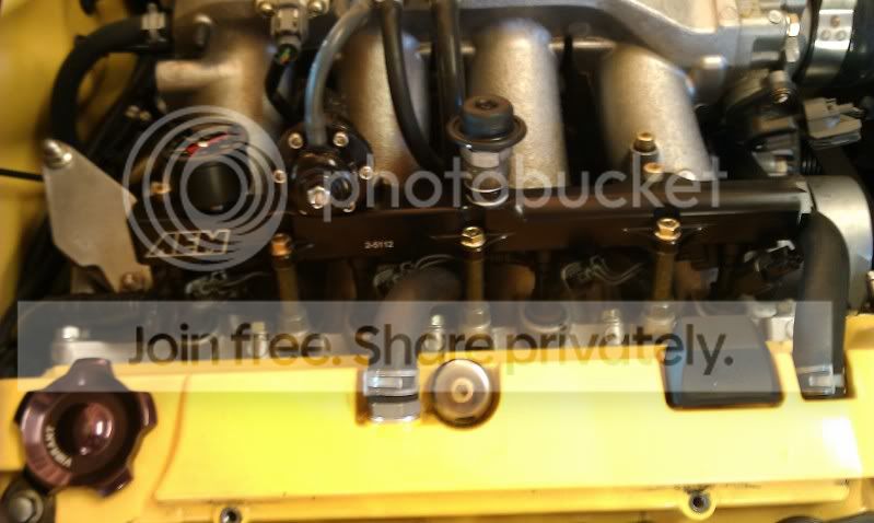

Alright so i was screwing around and un sealed the fuel rail and got a nose full of fumes. I tightened it back up with the 3 nuts shown in the picture below. Did i screw anything up or am i still golden?

As far as you removing (partially) the fuel rail, you should be good as long as the injectors seated properly when you tightened it back down. The opaque cover over the banjo fitting (fuel supply) can be removed, you will be left with just a metal piece (I painted mine black). Not much you can do with the stock FPR...I guess you could paint it (or buy an aftermarket one).
